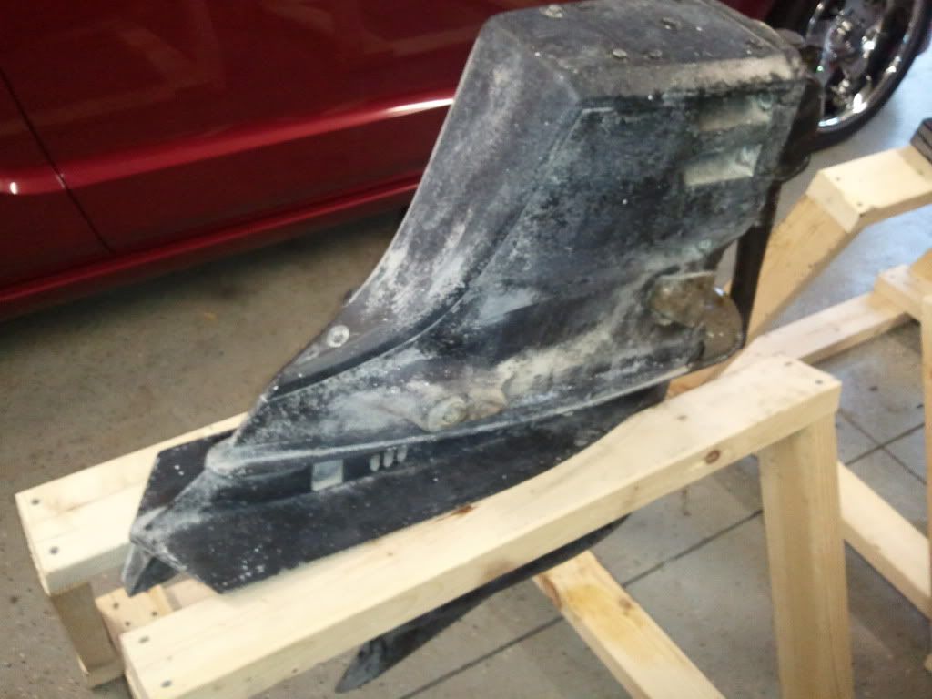

I finally got the stern drives off - built some stands for them as well.
I guess I am just wondering what I should be checking and what the best way is to do a pressure test, I would honestly like to just re-seal them completely. I am not worried about it taking time and it's not like I am in a hurry- I am posting a few pics too of the props. Anyone have any suggestions besides water impellers, gear lube was already changed.

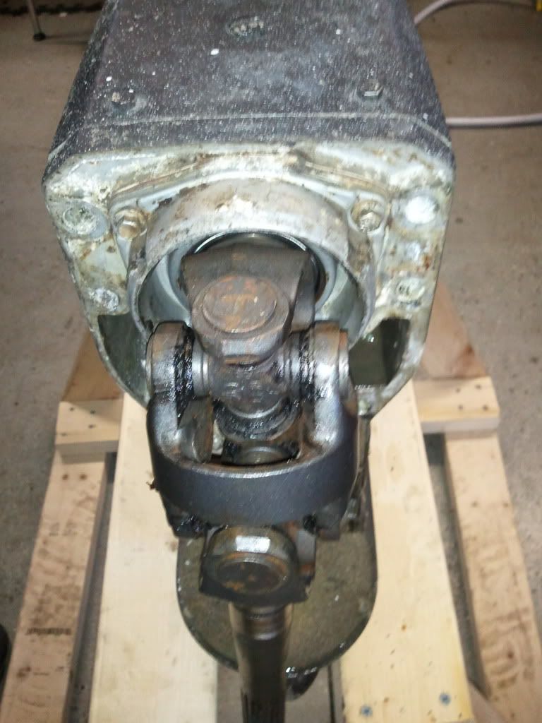

Did I see water or gear oil in that bellows? Your driveshaft and u-joints don't look rusted, but you want to check them carefully for wear. If it's gear oil, the input shaft seal on the drive has to be changed. I'd change the driveshaft bellows at least and take a good look at that little water hose when you're in there. The gimble bearing you turn with your fingers and feel for roughness, it should be completely smooth. The u-joints, you feel for looseness and play. While you have got the drives off, clean out the area where the bellcrank is, and then pack that area with OMC/Bombardier triple guard grease, that will keep the shifting from getting stiff. When you reinstall the drives, replace the gasket for the water passage hole on the left side of the pivot housing, and make sure to coat the pivot housing gasket with OMC gasket sealer on both sides. I replace the impeller every other season, it's an easy job on the Cobra, the impeller is under the plastic cover on the upper unit. 3 bolts the cover is off, 3 bolts the impeller housing is off.
You can make up a pressure tester and try to find where it's leaking, but other than the top cover seal, the seal for the shift rod cover and the bearing cover, the other seals need a mechanic because of the need for special tools (esp prop shaft seals and input shaft seal on the upper unit). It's probably worth checking yourself, but I had my drive re-sealed about 6 years ago and it's been fine ever since. I do replace the gaskets for the drain and fill plugs each season.

I do know for a fact that it has never been in salt water, but the outdrives sure do look like they have been. I would like to re-paint them but someone warned me to be careful because they are aluminum so I was not sure of the process in order to paint them. There was a lot of water in the driveshaft bellows on both sides, so I am wondering if those were the culprit and the drives may not even need to be resealed. The U-joints on the port side had lots of water droplets on them though and tons of condensation- looked more rusted then the one I took pics off.
