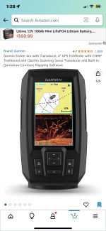

Ok I will look in the Manual. I put w30 in engine and a high viscosity in the drive. Steering is mechanical. Just need to check hydraulic pump fluid. Greased the mechanical steering rod. If I recall the drive have a zerk I can grease. Any other spots? I have a new blower coming since the one I have is slightly wrapped and screeching unless I move it a bit by hand. I want to get a fish/depth finder. Any recommendations? This is the one I’m looking at nothing to fancy.
