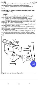

Also, I noticed a single clunk after putting it in gear and accelerating one time. The last two times I have taken it out from what I can read, Sounds like I need to check all the bolts and make sure the propeller nut is tight. Any thoughts?
