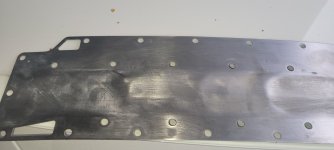

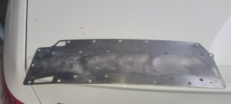

I took all the parts off the engine to clean and when I got to the exhaust cover I noticed the plate behind it was not exactly straight. It has a bulge in the middle that goes on throughout the length
of it. Is it mandatory that the plate is flat? I will.show a photo tomorrow.
Mine was like that on my old powerhead.....asked around and was told it was fine, not to worry about it. Even if you got it flat again it would distort over time they said.

I was reading on it and apparently if and when you get water in the cylinders that could be the culprit. That's why I asked.
To me it looks beat as heck.
Can you use silicone of some sort on the gaskets of these parts? I would not trust it without.
Mine looked just like that.....I used Permatex Optimum Gray with new gaskets....never had a problem. I agree, it looks bad...as long as there are no holes in the plate and it is sealed up good it should be ok. Maybe jerry or Nordin will chime in with their take on it.
Nordin
Jun 12, 2010
2,690
As long as there are no hole in the plate....no problem.
The plate will warp because of the high temperature from the exhaust it exposed to.
New gaskets and some liquid sealant to hold the gasket in place when assembling.
Your plate looks good in the pics.
