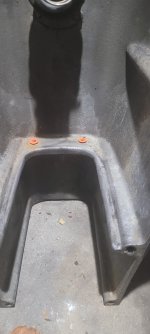

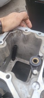

Ok so I am waiting for the machine shop to do the block reboring. In the meantime I am cleaning and prepping it all.
I have a question on a piece that fell in the initially dismantling. I asked this before and still have no clue where it goes.
The black plastic piece. The only place that it fits is in one of the holes from picture one. But there are 2 holes.
As you can see the cover that I had to remove to get to the bolts underneath has thise 2 orange caps. The 2 holes ho under that so mabe there should be 2 of those things.

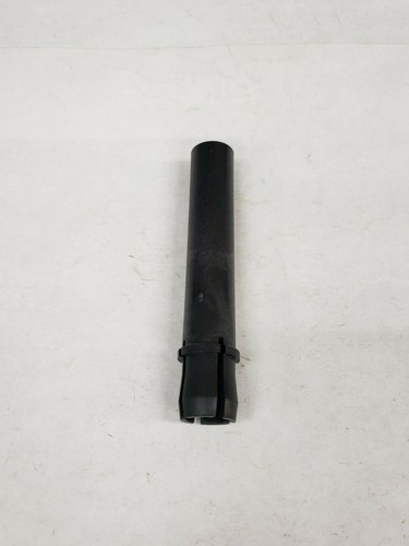

816515 Driveshaft Stand Tube
The question is where it goes it seems to be a single.
Anybody seen this before? If you opened it up it mu
See Jerry's post#45 for that.
The function of the two hole plugged with the orange caps; I've wondered myself :)
Yeah I have to order the second one, only have one.

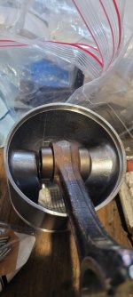

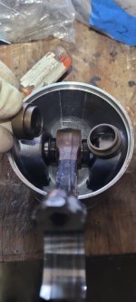

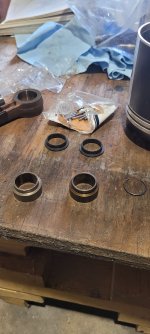

I have a problem. So the pistons from WSM .020 look a bit different inside. Model number 100-205-05k
O called and spoke to Florida tech support and they said this is the model
for 1990 Force B model 3.375 opening rebored .020. If you look inside thespacers don't fit anymore.
They sent their own needle bearing with washers. But nothing is holding them from spacing out.
The new pistons are slanted inside

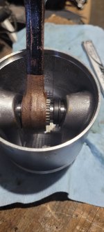

Ok I think they actually work. There is a little space but I think it's normal

That wrist pin kit is the one you replace the old thicker spacers and needles.
It looks right assembled.
Nordin
Jun 12, 2010
2,696
Yes, the connecting rod will need some play.
This is what I have had in all my restoration when using aftermarket pistons such as WSM, PRO V and Wiseco pistons.
Almost all those calls for this wrist pin kit WP29-1.

Ok that's all clear thanks.

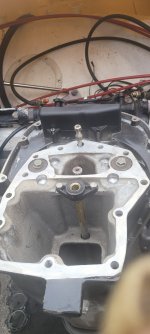

There is a seal that I want to know if it should be replaced. I am including a picture. Center black.
That's the water line bracket....there is a seal and a grommet that can be replaced in there.....doesn't look bad but since you're in there......parts are available.

So I have not heen able to locate the seal and grommet for the inlet water bracket.
Topgun3690 mentioned what they are.
Any idea on part numbers.
I think I might leave it as is if I cannot locate them. Let me know and thanks.

Grommet #25-817491
Seal #25-F84342 Ebay has them, marineengine.com has em also.....
