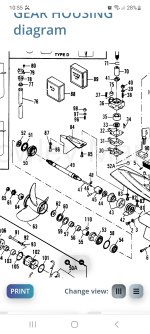

As far as the prop being too tight, I just removed the prop shaft and main shaft and as I mentioned above I removed one of the spacers that go between the cluch and the front gear. There were two there. The shaft was hard to turn when I tightened the retainer but after removing one of the spacers it was exactly the same as the shaft on the other engine.
I am including a picture of the diagram,
the spacer is number 44.

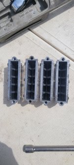

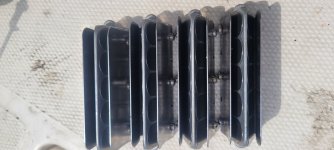

I took out the reeds and they are not the plastic ones. No light going through don't see cracks.
I also remived the fuel pump and the membrane shows a little tear. I ordered new gaskets and membrane for everything.

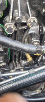

The elbow connector for tye cylinder drain cover was loose could turn it by hand. So I will have to remove it and tighten it.
I will change the hoses and add clamps. There are no clamps there, don't know if that makes a difference.

So as you can see above the reeds are stainless not plastic. They look new. I am waiting for the gaskets to put it all back. As I said the membrane on the fuel pump had a little scratch looking mark along the circular line. It was showing only on one side of the membrane not the back. So, I ordered another one since I don't think there should be any marks. I am also waiting for that. I sure hope I find the reason I get this dying in gear issue, but it has to be a fuel supply problem?! The lower drive is not tight anymore.

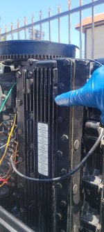

I just sprayed 1 can of starting fluid at the intake recirc area and nothing. If I spray the carbs at the mix screws engine dies it hapens on both motors.
Ok I just sprayed the exhaust side and one area caused the motor to bog down and even died once. Can that cause bad idle?

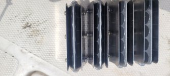

So when I rebuilt the engine I changed the gaskets. Here are pics of some of the bolts from the exhaust cover. One in particular is rusted all the way in. I am sure I cleaned it when I put it in. I did not use any sealant on the bolts though.

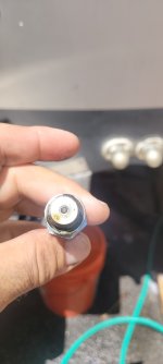

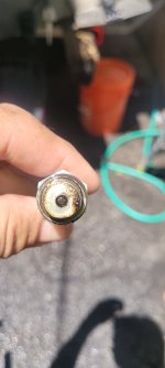

Here is a picture of the spark plugs after usage. The problem engine plugs are pretty clean with a drop of black fuel/oil mix. I don't even know if that drop is oil or water. The other engine plugs look different.

Clean plugs maybe is a sign of water intrusion.
Check the head gasket, looks like it is okey from the compression numbers but there are also a chance it will have water intrusion from the exhaust side.
Leakage at the gaskets at the exhaust cover can also cause water intrusion to the cylinders.

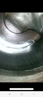

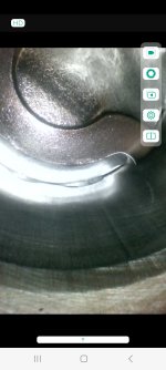

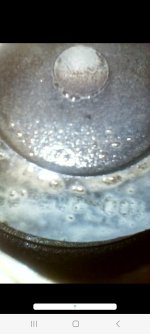

I just took a picture of the #2, 3 and #4 cylinders with an endoscope cam. #2 and #3 look dry #4 looks wet that is not normal right? Even thoigh it's the bottom and everything reponds to gavity.
I am taking off the exhaust cover. Should I take the head off also. I did get good compression at 140 and 135?
