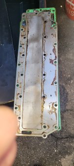

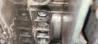

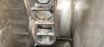

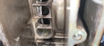

Ok took off the cover and I see milky stuff on the 3 and 4 exhaust chambers behinfld the cover. See pics. I need to buy that separation plate as it is too deformed.
Should I remove the head also?

Nordin
Jun 12, 2010
2,686
You do not need to buy a new separation cover plate.
It will be deformed too as the heat from the exhaust will make it to warp.
use the one you have.
Check if there is some leakage at the covers or damage.
You need new gaskets and yes pull the head too and check the head gasket.
BTW Another possibility of water intrusion in the bottom cylinder is a bad crank seal at the end of the crank shaft.

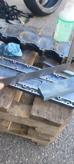

The exhaust plate was pretty warped. I was 0 020in în the worse spots. I used a special stone and brought it at 0.002. I think that even with new gaskets and separation plate it would have still leaked.
I already got the plate for 75 shipped, no biggie. I actually had to re-surface the exhaust cover, it was warped 0.020 which is bad. I used the sharpening stone in the picture and it is now at 0.002. That is acceptable. The crank seal at the bottom was replaced when I rebuilt the damn thing. I had the crankshaft out in pieces. Every seal on this engine is new.
The exhaust cover was way too warped was wondering why every time I torqued the bolts they were loose again in a few days. I will now brush some liquid gasket maker 500C on all the surfaces and use the recommended 750 industrial sealant on the bolts. I truely hope it is the end of the ordeal. I mean there is no part of this motor I haven't touched.
I am just sorry I didn't check the cover and use a straight edge to check the warping. It is weird that the boat was able to ride at all. But the water obviously affected the running at idle in gear. I guess water doesn't light up like gasoline and oil hahaha. I sure hope there is no other reason for the leak as you mentioned. Fingers crossed.

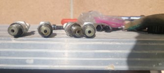

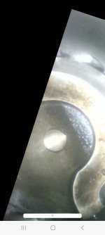

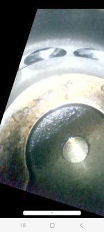

So I got all the parts and put the exhaust cover back with the new separstionplate, straight enough cover, and gaskets plus sealant between it all. I even bought new stainless bolts and some washers. I also changed the power head with another one that is a little straighter and no damage inside. Mine was scored a bit from the bad piston in the past. I put it all back and I started it in my home made tank and it runs pretty good in the tank. I had it at 1050rpm. The water jet from the tale I installed seemed more powerful than before. I hope this does something to my issue of dying in gear. Number 4 piston
looks ok after half hour of running. I don't see water on the piston surface like before.
I am including the spark plugs oicture they have some oil on them and a halo light beige in the center.
If this is it and the water issue is solved
Will it fix the dying at idle in gear???
