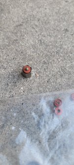

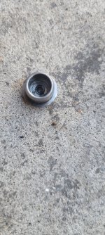

https://forums.iboats.com/threads/some-hints-on-the-t-t-repairing-the-relief-valve.697972/ Look at this thread by Jerry....the valves have to come apart.....without damaging them. He used some panel clip pliers, washers, and heat to get them apart. It's all in that thread.....if the check valves get damaged they will be no good, that is the hardest part of the whole deal. I bought the pliers from Harbor Freight.....they were pretty useless. There are better ones out there.
Take the black o-rings off and save them....before using heat. You will need them when putting back together.
