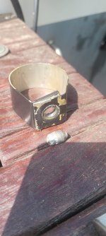

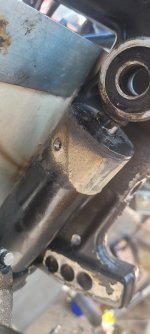

This is what I need right?
Got it out
Cheapest I found is 471 on Ebay.
So Jerry where did you get the $25 one?
Wonder if they sell the nipple fitting only?

One of my customers said he had a bin of Chrysler/Force parts.
Asked if I wanted them. $45 talked him down to 25$
They don't sell the nipple fitting alone.
Where do you live? Look around at the local salvage yards and you might get lucky?

It's ok I bought the $71 one. Hope it solve the issue. It's a good thing they are still available.
Was thinking the only way to getthe bottom bolt out is to sacrifice the trim unit which seems to come off seperatelly.
So cutting it off gets rid of most of the shaft piece. So you're left with the ends which should come off, If needed
