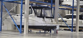

mart284
Aug 22, 2024
72
Will start the "pipe dismantling" project in November to see, if there are something inside the pipes or water chanelles, also will check that water inlet is clean - filter was and water is flowing, but something somewhere most block the flow. Anyway - IF I will reach to some conclusion, will let you know here as well.
