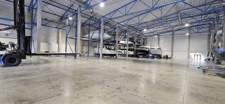

Sad to state that nothing has been done with the boat - will start dismantling process next month... Sadly standing alone in the winterspot and waiting for a better summer...
