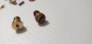

Also when rebuilding the carb i noticed the new power jet is way diff then my old one, i just put back the old one but i kinda damaged it but the pin still moves freely.
The one on the left is not the right power valve, there is no poppet sticking up.
You need to notch a crew driver to remove the power valves with out screwing it up. There is a video at Mikes carburetor parts that shows this. Be careful if your now beat up power valve is hanging up it will run rich or lean depending on if it hangs open or closed when it shouldn't need to move freely

Whats different? I'd go with the new one.
the new one is hollow from the back the original one had a small hole. Also its missing the pin, its just way different.
exactly its different ill order another kit and do it right this time.
