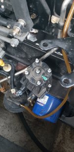

ok i tested all the cables and spark plugs with multi meter and all are good the inner contacts of the distributor cap were corroded a little i cleaned them out it back.I also turned the idle screw clockwise some more and she ran for like 10 seconds and turned off ?? 🤔🤔 i just rebuilt the carb again. For the float drop i measured about 20/32 and upside down around 1 and 5/32 close enough? i added a little bit because the gasket in the kit was superthin not like the original one. all thats left is maybe timing or distributer off ??

here are pics of the cap

And get a new cap and rotor. I'm wondering what the orange stuff is under the inside of the dizzy?

yes timing but you mention. Idle speed screw adjusting improving it, try turning it in more to open throttle blades some. It maybe be backed out too much or linkage was reinstalled wrong to keep it idling. Does choke close and is idle mixture screw out about 1.25-1.5 turns ? You can loosen the distributor hold down bolt and turn it while cranking to see if moving the timing gets it running.
