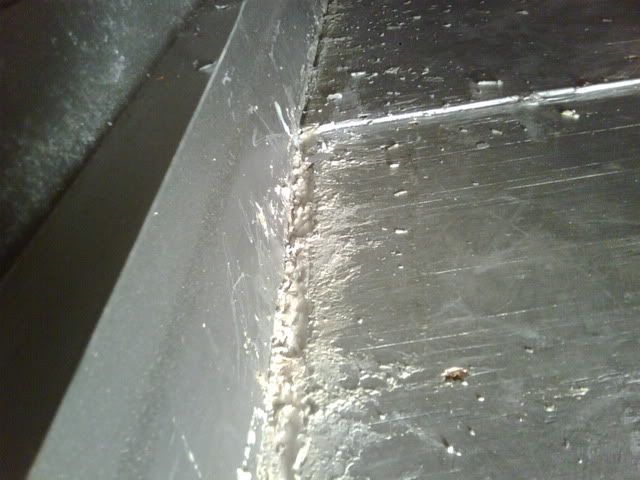

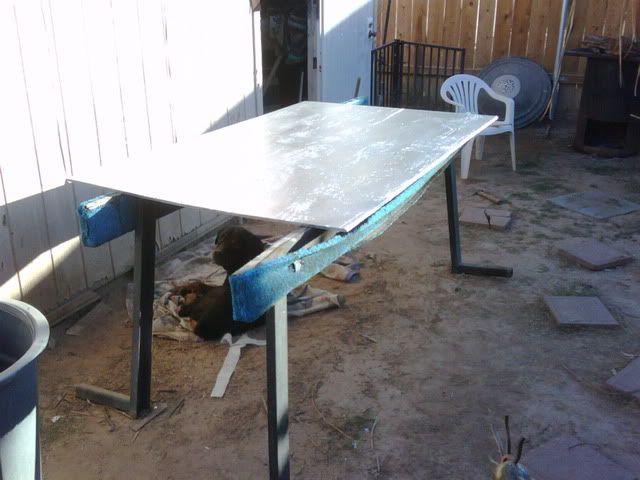

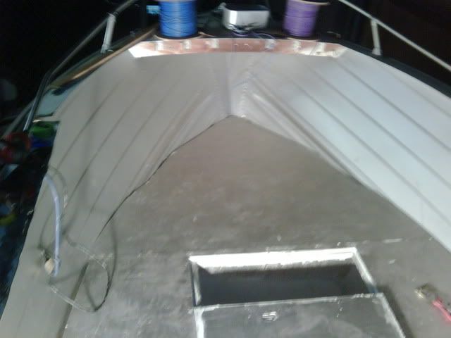

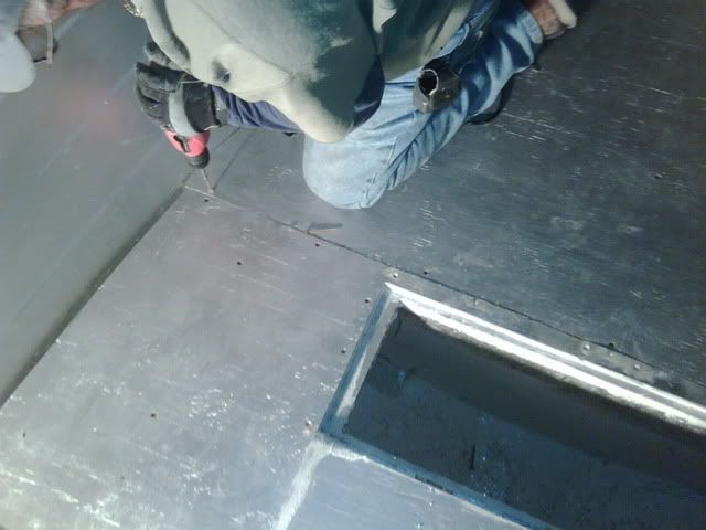

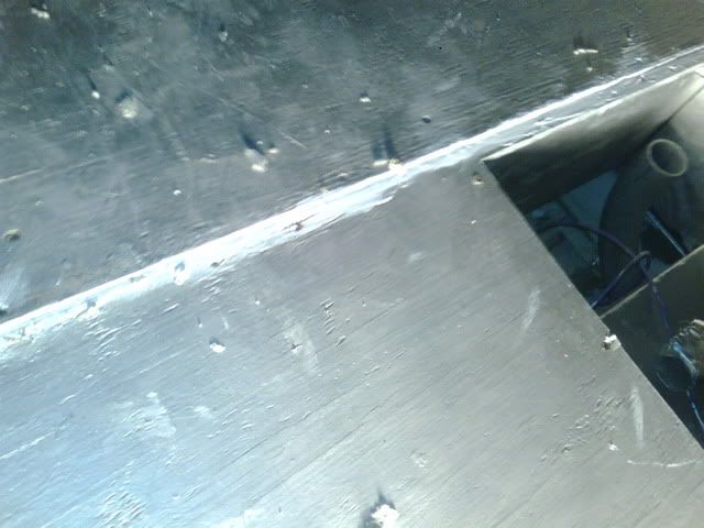

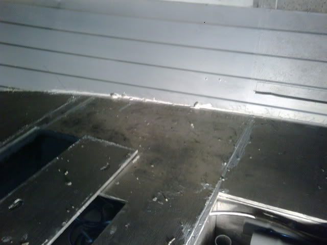

here's how the aluminum paint looks like in the sun.
Finished securing the bow area deck tonight.
We're going to use 3m 5200 to seal all the edges around the deck. We want the least amount of water to go down through the bow area were most of the foam is.

here's how the aluminum paint looks like in the sun. We're going to use 3m 5200 to seal all the edges around the deck. We want the least amount of water to go down through the bow area were most of the foam is.
Have you considered using something like pipe insulation foam around the decking edge, then sealing the foam with 5200? That would keep the deck from chafing, plus add another layer of protection.
Just a thought.
evildocrsx
Aug 1, 2009
244
Re: 22' 1968 Starcraft Islander
That's kind of what we did. We filled the edges with spray in foam and trimmed the excess and coated it with 3M 5200.

When I was painting the deck outside of the boat, the glare was killing me. I noticed that it also reflects the heat really well, so it will definetely not be this color for fishing. It would be like an oven.
