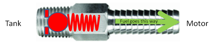

Either the fuel pump is not working or there is a restriction
A restriction might be the antisiphon valve that the rubber fuel line connects to on top of the tank
The fuel line between antisiphon valve and fuel filter might have collapsed or the tank pickup tube might be clogged. Most probable cause in my opinion is the fuel pump or antisiphon valve
I would start with removing the valve and cleaning it.
Oh and the fuel tank does have gas in it right?
What is the anti siphon valve? I'll attach a picture of the fuel lines.
Yeah I filled it up in the fall... still need to figure out the issue where the fuel overflows out of the fill tube on warm days...

The antisiphon valve is at the end of the rubber fuel line coming from the gas filter. It's a screw in barbed fitting that the fuel line attaches to on top of the fuel tank
You mean in there? 😳
