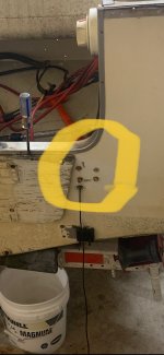

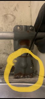

I wonder if those fittings (doubt they're Cu...maybe brass or bronze) are for running kicker fuel line and maybe control(s). would a 5/16" fuel line fit through there? where there also holes in the transom wood there?

Yes at least one has a hole going through the riser then into the hull area. Heres a question, can i hook a separate gas line to my kicker through a Y split from one gas tank? Or should i just resign to have 2 tanks? Ill check the gas lines i have for a trial fit. I was happy with the bow cut out as well. Thinking about the design the structure for the bow deck is mind numbing haha! I can install float foam in the mean time.
Yeah that shouldn't be a problem tapping into the main fuel feed. I don't believe that it will effect operation. The only reasons I can see keeping them isolated is if it's a 4 stroke and your main engine is a 2 stroke (or vice versa) or you like to push the limits on your fuel capacity and your kicker with a separate small tank is your ticket back to port should you push a little too far.

The steel Mounting of this bracket was causing problems. Can I opt to NOT put it through the transom with bolts but screw it into the transom with SS lags or something?
