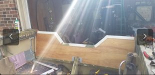

New item to think about. My transom cap is in bad shape i would say. I have seen a couple ideas on how to make a new one but thought i would throw it out to the group to see what yall had come up with. shoot me your links/pics/ideas in writing, I want it to be much more substantial than the original that's for sure.

With angles in my transom I could snip it in instead of bending the channel. In hindsight I liked it because I glued/5200'd the heck out of it and used a few tack nails on the sides to hold it down as it dried. I wasnt to worried about exact angle cuts. It could have been nicer.

I used a 6' section of aluminum channel that fit 1-5/8". Used the transom and the cut out, along with a little physical persuasion, to bend it into shape. Not perfect, but much better than the trashed original.
What process did you use to "persuade" it? This is close to my imagined result. Looks really good

I made a DIY jig out of scrap to place on the ground and bend it into shape. I used the cut out from the new transom screwed to a sheet of scrap plywood to set the angle against, another scrap piece of ply to give it a lip over the top and keep it in place, then some 2x4's inside the angle to hold it in place and bend it into shape. I didn't use heat, but probably would have went a little easier if I did. From there, I put it on the installed transom to fine tune the bends and cut to length. I doesn't lay perfect, but the screws and 5200 pull it into place.

also known as percussive manufacturing..... hint - heat the aluminum to about 550 with a heat gun, and use a 2" piece of dowl or bat under the hammer to smooth out the bends a bit
