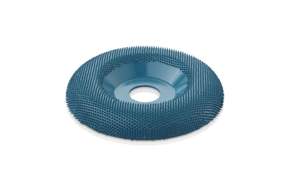

The right tool for the steering arm cut out is a Kutzall wheel for your angle grinder. Spendy but something to have forever.
