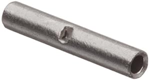

I used non insulated heavy duty appliance butt splices and terminals on my motor along with epoxy lined shrink tube.
