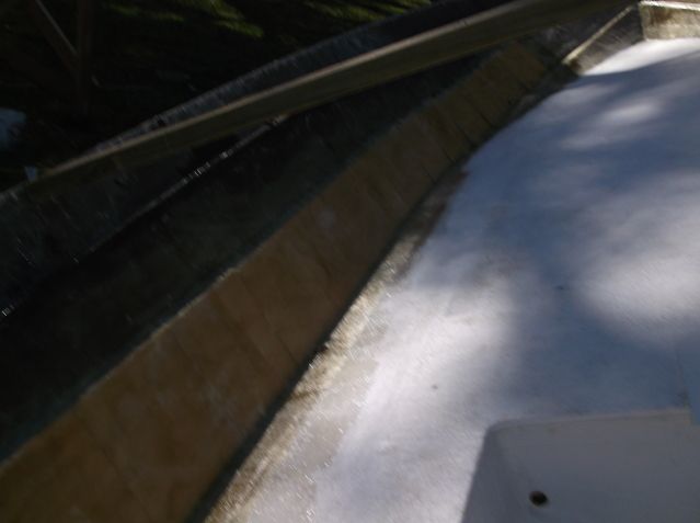

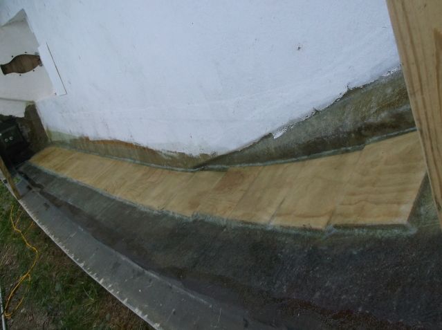

Thanks guys...as promised pics from yesterday...
Side 1
Side 2
Woodonglass
Dec 29, 2009
25,932
Re: '78 Ebko Lebaron - Therapy
Looks good troop!!! I got a package today!!!!:D Want me to check out the Morse SM?? I still haven't went to look at it but I did call her and it's still there.

Hull faired & sanded ~ Check :)
Gunwale blocks ~ CHECK :)
Ok, now what? :rolleyes:
Looks great!
BTW: I vote yes on the Morse!

What did ya ...How did ya .. I thought your boat was in the upside down position ...Did I miss something ?
Hey SP...I just flipped it long enough to get some glass over the boards...don't want them getting wet..then flipped her back over...maybe get the hull done this weekend...but I have concerns with the pressure pot...next post...

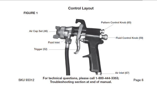

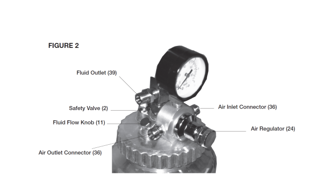

Pressurepot questions...
So I picked the pot up from HF...got the 1 yr warranty....
Took it Sunday and filled with water...wanted to see how my compressor would handle it...
For starters...the Fluid Control knob was hard to turn, but I assume it is either open or closed...no fine tuning?
Next the Air regulator...I could not see any difference on the gauge no matter which direction I turned it...I assume screwing it in raises the pressure in the pot? The safety Valve worked, like every 3 seconds it went off...again, regardless if which direction I set the regulator.
Then comes the spraygun...
Pattern control knob only turned about 1/16th of a turn if that...I would think it should turn a little more? The rod was bent...was hard to get it lined up after tearing it down to see how it all worked...
The Fluid control knob turned like it should, but again, the rod was bent badly...is this common?
I also had a stream coming from the aircap...where the rod should cover the nozzle.
Air leaks all over this setup..from the regulator, the trigger...all hose connections...I even used teflon tape everywhere...
Also water leaked from the fluid inlet on gun... thinking I got a lemon and need to return it for a new try...opinions?

Absolutely, returned the sooner the better. And asap test the replacement. Is it a online mail order, or a drive to the HF store? mail order I'd have to think carefully before accepting a replacement.......
Does that paint site WOG posted w/ the $99 3 pack paint gun set sell a pressure pot?
I can't remember the site off hand, but I have it bookmarked I think. TSR sounds about right, but not quite it..
EDIT: It's TCP Global, and yep they've got a few pressure pots & have 1 pressure pot priced the same as HF
Trooper82
Nov 21, 2011
2,648
Ya just a short drive to get a replacement...I was kinda leaning that way...thanks for the input!
