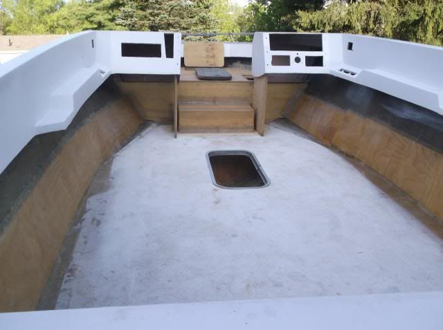

ok, getting the sense I spend too much time talking about anything but the boat....so......
Back on topic.....

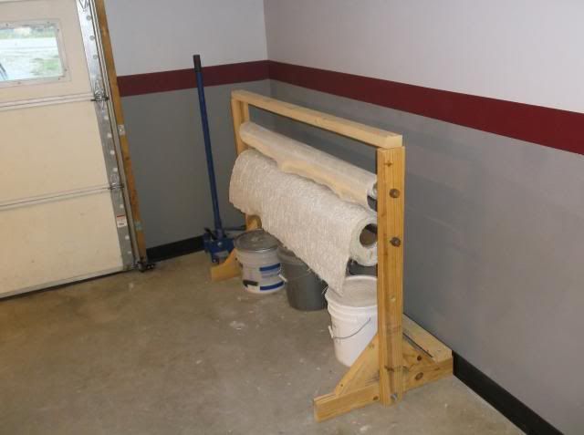

Technically not the boat...but I needed to take the rolls of glass out of the boat and thought the rack needed resized....so scaled it down abit...

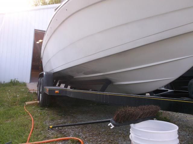

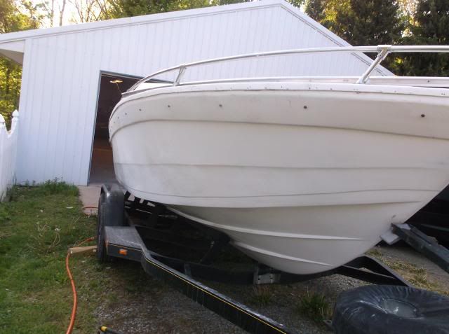

Decided to pull the boat out and wash the grime off her....
Got the inside cleaned out...
Washed the outside as best as I could...looks a little better..
Closer inspection shows it was tough getting her clean...

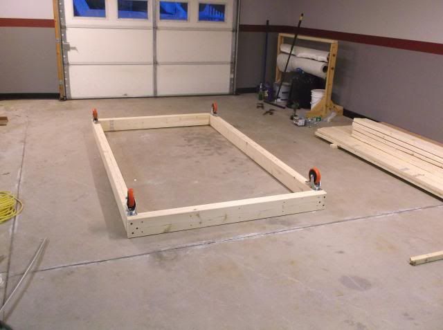

Got some supplies...
Started on the base...
Sure hope those casters hold up!...still alot of work to go...

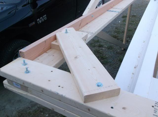

Have an idea on how to make the cranes...looking for some input from you all...
See anything wrong with making the uphill one slanted to make the upright vertical to gravity? I was thinking I could use 2x4 straps to keep the angle strong...the down hill one will be level....just don't want the top one toppling over...

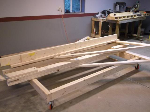

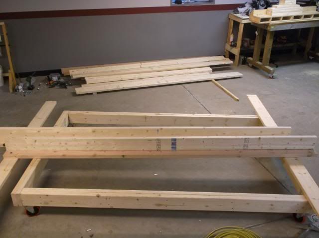

Got the casters mount tonght..then started on the TGS2.0
That's the Trooper82 Gantry System 2.0 :)

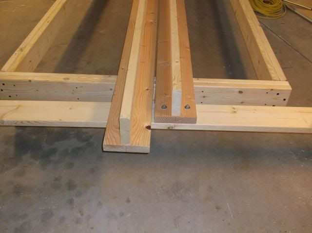

Got the T's made...
A second angle so you can see how I put the parts together...that is a top and bottom together for comparison...

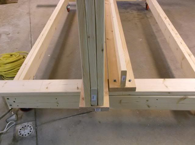

Here is how I plan on putting the header span in...I think it will hold just fine..
I plan on using taller angles in the bottom of the inverted T ....not so sure yet what I'll do with the T to header bracing...welcoming any and all input.....

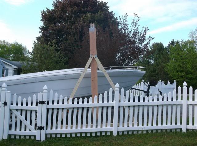

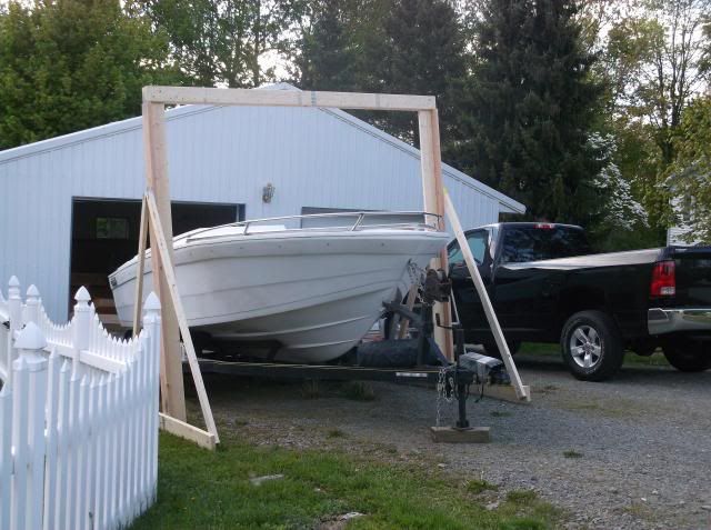

Got the first frame done....

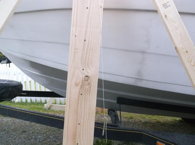

Made a slight modification so that the header was supported with the 2x8 and the 2x6 sides....and you can sort of see the angle I would be dealing with on the bow end...
Even better representation of the angle...this is about 5' ofstring on the makeshift plumb bob....
Color coded the pieces so I can store it indoors when not in use...
Wish I knew how to slow these down....went from 10 secs to 30 thinking that would help....I see no difference....EDIT: Figured it out....will update tomorrow...with a little slower version...

WOW there's that guy Flashing across my screen again..:bolt:
Nice work and color coded too.. You do have a slight angle on the driveway..
From where I sit I don't think you will have a problem with the flip..
Are you going to leave the cap on or pull it off before the flip??

Looks great, just watch the gantry as you start to load them w/ the weight of the hull, and only lift it as little as needed to get her flipped. Slow & steady, you'll get her over.
Another fine gantry system. TGS2.0 looks about ready for service....

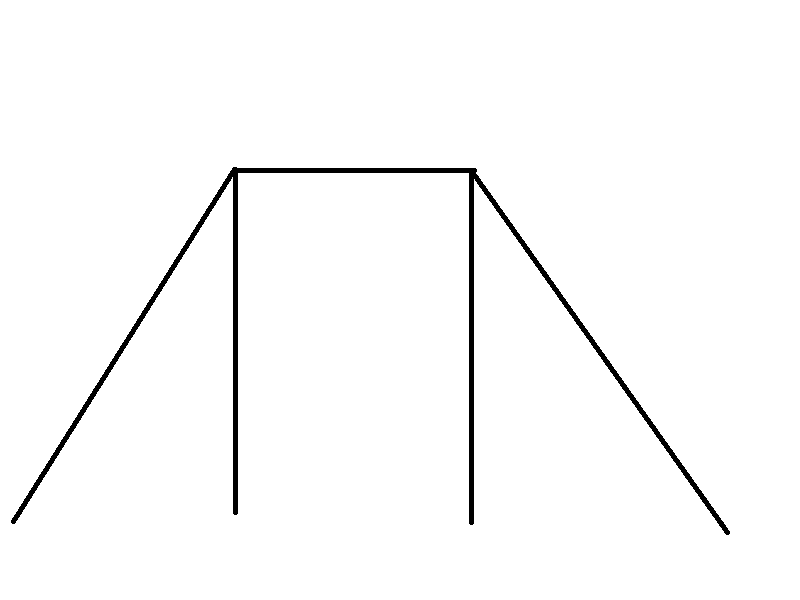

Hey Troop,
Just a thought, I don't see any 45? braces in the top corners...now don't get me wrong, I am not doubting your engineering, but maybe as the boat is flipping, it might load the gantries in such a way as to want to sway them at the most inopportune time...
My thought is to just add some outriggers to the exterior of the gantries...kind of like this...
:noidea::)
Trooper82
Nov 21, 2011
2,648
Re: '78 Ebko Lebaron - Therapy
Most observant of you Gus...I just had not found a way to get the gussets on last night..will have something tonight I hope :)

+ 1 on the lateral bracing Troop . You could tie it to the fence post but I don,t think the Admiral would think to kindly .. :rolleyes::)

Well...I thought I might work on the bracing tonight...get things ready for pulling the motor this weekend...
and here is what I came up with...
still lots of daylight left...only 6 nuts and 2 bolts holding the motor down.....what the heck...let's pull it tonight :)
Note the Admiral giving a double thumbs up behind my back there in the last frame...she sure puts up with alot when it comes to me!
Got the crane pulled apart and waiting for the flip...that is gonna be the weekend for sure...
EDIT:I should mention that the crane did not even make a single creak or squeak....rock solid too!
