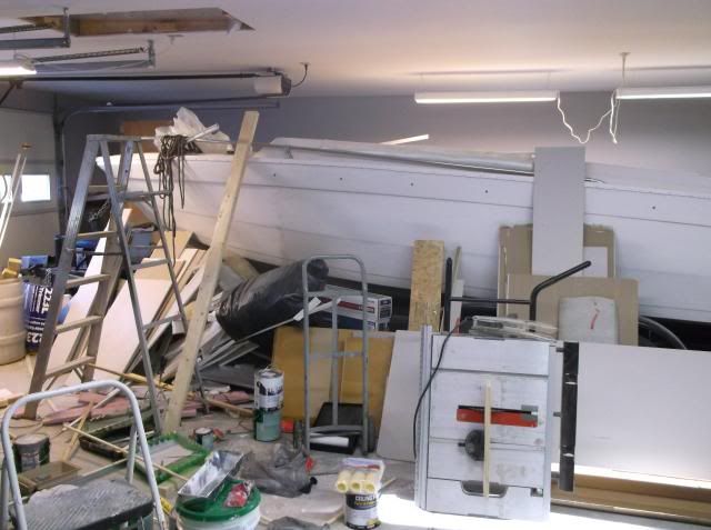

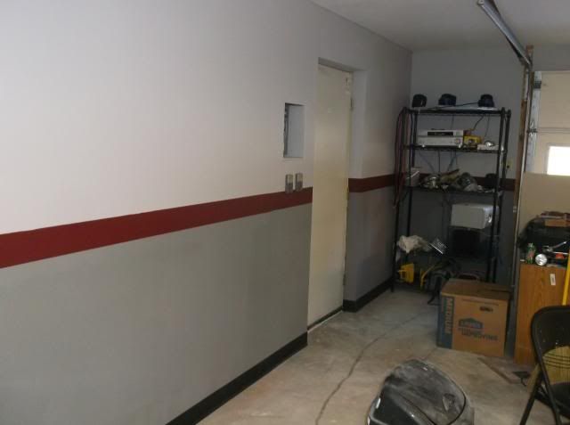

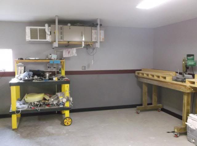

Bout as done as I am gonna get for awhile I spose....still need to do a frame of some sort on the windows..and attic access...got the painting of the walls done...and you can see the 2nd can of paint didnt match the first on the lower section...you can see the touch ups...oh well it's just a garage...
got the door area done...I left access to the wiring coming in from above, just stuffed insulation up in it...on lower section I made a slide in piece from sheetrock..that way I have access there if ever needed....got the garage doors working, remotes mounted...eventually I will need to install some switches for lighting....
SO.... let's get started on some boat work!!!
well...as soon as I can find the boat :(

Very well done Sir..
Now where did I leave that confounded boat..:D

Man Boat Cave looks awesome, bro!
Super nice job!:encouragement:
A little more organizing and the Ebko is back on the front burner...yeah!

Garage looks ready to have the Ebko front & center. Awesome.

What a great looking garage Troop ! Just a bit of organizing and clean up then some Ebko fun work !
Btw , don,t forget to clean out your mud pan .. :D

Just realized the part about the lower color not matching perfectly...
I know I am late to the party, again...but...
Here is another of those painting tips from my bygone days...
You will need a spray bottle with some plain water in it and the new color and a good 3"-4" brush { preferably something like a "Purdy"}
Where the old color meets the new, paint the new color, and use the brush in a criss-cross, X- motion to help blend the new color into the old...use a little water sprayed on very lightly with the spray bottle to moisten the paint enough to keep blending it into the old color, using the X-motions, until it practically disappears into the old paint...with a bit of practice, you won't be able to tell where the colors meet, and it will fool the eye into believing they are the same...

:eek:Please tell us that the EBKO was not harmed in the photographing of this update...

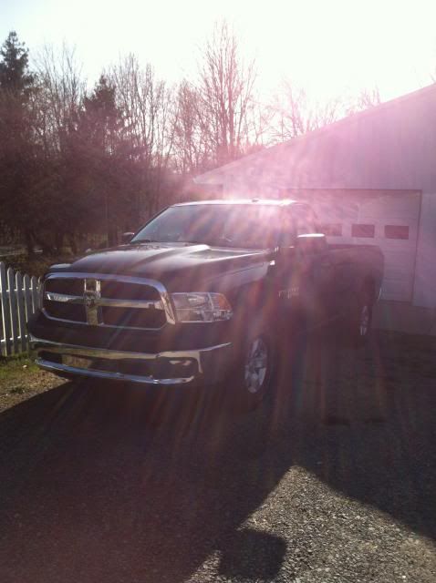

well, I needed a way to pull the boat....so the Admiral said I could get one of these...
Thank you Patty!!!!!

Now THAT's a Great looking Land Yacht!!!!! Should pull the H2O counterpart with NO Problem!!!!

Wow ! Now I got some serious tow rig envy ! :facepalm::D
