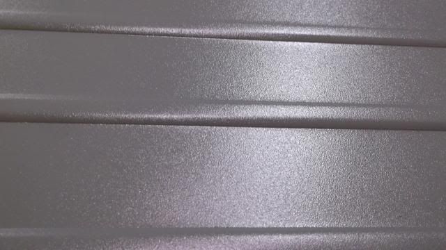

The primer is dry, sandable, has a very nice feel to it...think I will spray some paint tonight after work!

Speaking of finish coat(s)....I just sprayed everything and a couple more pieces...didn't even use half a pint? The Admiral thinks it looks good....
The paint I mixed is awfully close to the same color as the primer...Just eyeballed it from about 6 feet, so not sure how that happend...
The pot will last 8 hrs...but the hardner can says 24 hrs between coats?
Do I need to worry about it?

Glad to see the primer worked for you.. I would not use the paint after the 8 hrs..
Looks good..

Decided I could live with the paint...
Still have to put the guts back in, angle plate for the front...make a handle for the other hand wheel...made one already...

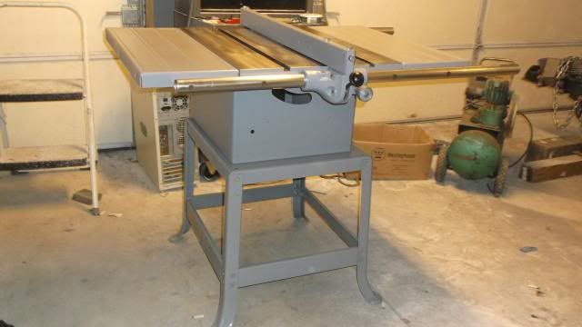

Woo Hoo!!!! You made My old table saw look like New!!!!! Way to go Troy!!!!!! Let me know if you need any help with setup and tuning. I KNOW that saw better than most!!!:D

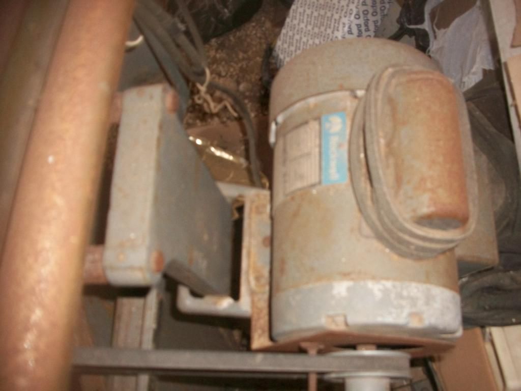

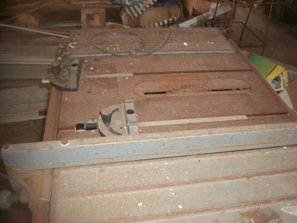

I have what looks to be the same saw i found buried in the back when i got here..it has some surface rust, but looks complete. I havnt messed with it, but after seeing how good you made that look, i may have to pull it out!!...thanks for putting another wedge between me and my boat LOL...its a belt driven motor i believe..

Saw looks brand new!...Grrrrr-8 Restoration!

you have two miter gauges. Want to sell one? That could be a nice looking saw too, little elbow grease, some paint stripper...
zool
Aug 19, 2012
3,433
Re: '78 Ebko Lebaron - Therapy
Ohohoh!
Not sure why there are two, but one seems to have a longer rail than the other, will have to take a closer look. If the rail size is the same between the two saws, and they are redundant, ill just give it to ya man...... If you dont mind me askin, what did you use on the unpainted area to keep the flash rust off, like a linseed oil, or a wax?
i was just kidding ya zool...I did notice that one is longer than the other, the long one would be for larger work especially when doing angle cuts....
i used a scratch pad set my spinning sander on that to get the rust off, then applied johnsons paste wax for floors...keeps it sealed from the air and makes it nice and slick...
that saw of yours will clean right up I'd say...maybe some pitting....mine had a few spots too, but not too bad...

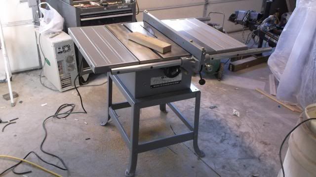

Replaced all the bolts with some grade 8 bolts, found a replacement switch, got everything wired up...blade tuned to be square with the table and the miter slots....fence lined up on the slots...think it is ready to make chips...need to get a new blade though...this one cuts but it has a few teeth chipped..
