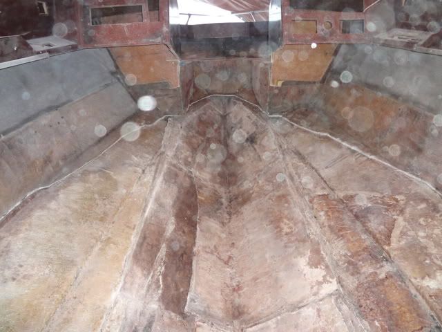

Kind of hard to tell from this pic, but I got the balsa core up on the bow section. I even got some of the edges dressed up in the bow where the deck was, getting it ready for grinding and started the mid section before I gave up.

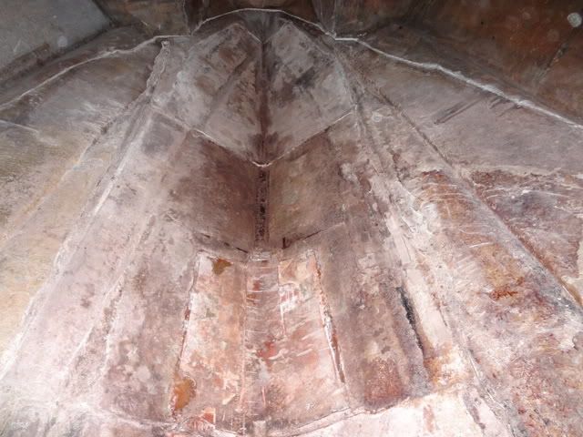

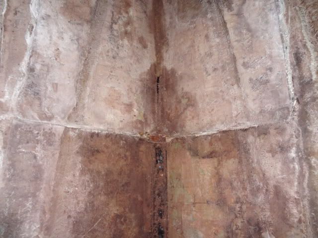

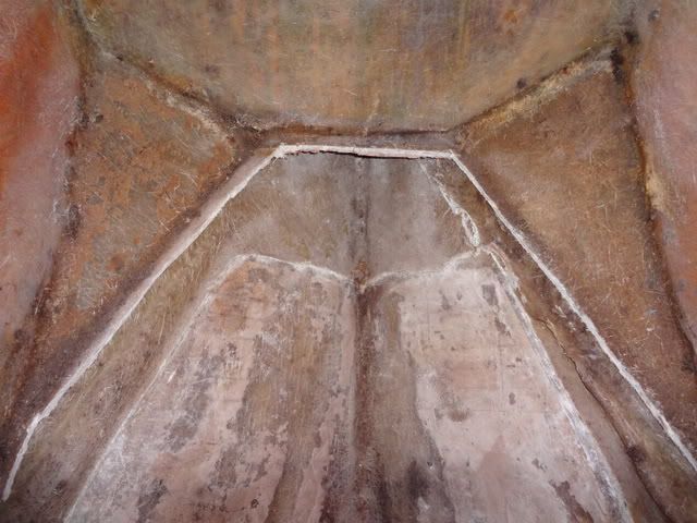

Well I got most of the midsection of balsa core removed today.

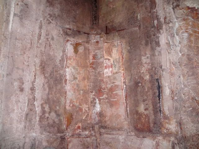

As you can see in this picture there was a newer fresh part that was mostly intact, though it was moist. Hard to get out too!
Close up of this area
This is where the midsection meets the bow section, the bow section has about 1/4" of more fiberglass on it than the middle secdtion had.
Will this need to come up?
Still yet another layer of glass here in the bow, this need to come up?
Tomorrow the plan is to finish the midsection then attack the the rear section. Once I get this I will be ready to get the motor out and start the bilge area and motor mounts and remainder of the stringers.
Making progress!

Where you removed the balsa,I wonder if you could build it up with 1/8 inch plywood veneers and epoxy.I think it would be stiffer and the hull could with stand pounding through waves without twisting and flexing.A stiff hull is more effiecent hull.Just an idear.

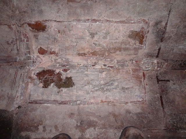

Re: '78 Ebko Lebaron - Therapy
Got most of the balsa up in the mid section, what a chore! not sure what this was laid down with, but there are 2 huge chunks of it on either end of the area. The stuff is very brittle, no glass in it from what I could tell. Dark in color. I have seen it in several locations from the last work that was done on the boat.
Will try to get the aft section up this week. Then long weekend to get the gantry crane and motor cart put together then try and get the motor pulled out, only if the weather holds up. Been very wet this past weekekend, yard is very soft, won't be pulling the motor in this muck.
Wasn't much today, but it is progress.
oops!
Oct 18, 2007
12,932
just glass it......one csm and a full 1708 wrap....then feel the hull.....is is stiff?,.,,,,if you like it ....great....if you dont....then hit it again..
2 layers of 1708 is just about as thick as a hull....
if you re foam the boat with pour in....that will make it plenty stiff with just one layer of csm/1708,
i would leave the bow area.....unless its wet.

I already took the bow core out, it was wet. The rear section may have some dry wood in it. The section I finished up today was dry on one side but wet on the other. I figured if any wet at all I would just take it all out. Guess I could just remove the wet, get to good dry wood then move on. I know my hands would appreciate that. That stuff is hard to let go once it is down.
