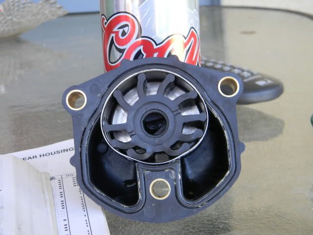

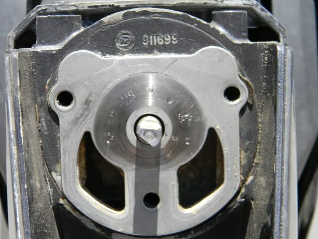

Maybe getting closer pulled impeller cover just now and the direction of the vanes do not look right to me this is the way it came off.
Plus the exhaust port behind the impeller is still full of water I would think it should have drained out? Maybe I have a blockage in the passage behind the impeller in the casing? Going out to try running water thur it now and see if it exits thru the prop.

looks like your backing plate is a bit dinged up.

Cobra impeller mount.jpgGlad you got it, I could see dings on that impeller plate and the cage that the impeller lives in looked like it had some wear marks on it. I usually replace them every 2-3 seasons unless something happened like sucking up sand. The Cobra impeller is actually pretty durable. A couple of tips, make sure that cage is centered in the impeller housing, I like to glue it in there with a little OMC gasket sealer (it says to do this in the factory shop manual), the wear plate you can flip over and clean up the reverse side and re-use it if the back side is in good shape. I also use OMC gasket sealer on the gasket for the impeller housing. The next time you change it, try this. With the impeller housing off, hook up your ear muffs to the lower unit, put the hose on full blast and then squeeze the muffs tight to the lower unit so the water does not spurt out around them. With the impeller off, you should see water come out of the water passage on the right side of the spot where the impeller mounts. The water enters the housing from that right side opening and gets pumped into the transom house through the left side opening. It takes a full blast of water to get it up there though. I took your pic and labeled it so you can see how it works....
