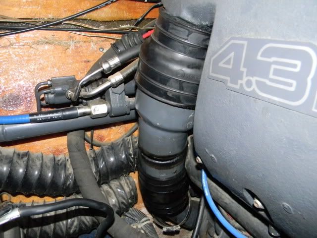

OMC manifold change.jpgI copied your pic and showed you where to spray some silicone spray so that you can slide down that lower hose on to the Y pipe. That hose has to slide down before the manifold will come off. Once you get that lower hose down the manifold will come off easily and then you can remove the upper hose and the aluminum exhaust pipe with it. Then check the outlets for rust clogging. As clean as that engine looks and fresh water use, I'd be a little surprised if they were clogged....

:) OK got the bellows down just now so I am ready to pull manifold tomorrow night. I can see the shutter in there looks good once manifold is off can also check the power steering cooler and clean out since I am there. I did run a wire up into the manifold and ton's of junk did fall out. Here is where i am at now.

When you have em off, look in the exhaust ports on both the engine and the manifolds, if you see any signs of rust trails it's time to replace them. I doubt it because of the freshwater use, but they are the OE ones, I can tell by the 4.3 stickers. You can also hook up a water hose to the inlet while you have em off and check the flow out of the 4 exit ports.
Look at my pic of my engine above, see how all there is in the ex ports of the engine is carbon? You should not see rust there.

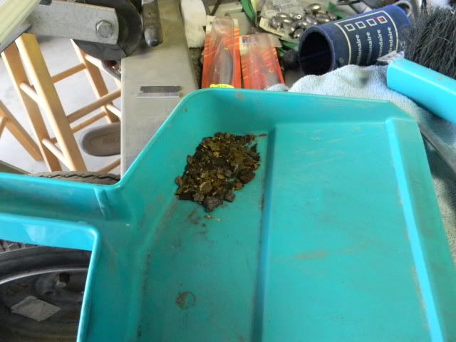

OK soaking manifold again p.s. filter good no clog there here is what I got out before first soak with iron out.
got about that much more out with first soak ten more min's and will flush and see what come's out on second flush.
Be careful with iron-out. I love the stuff and have used it on non boat things as well as my manifolds. It's aggressive and doesn't always know what you want to get rid of and what you want to keep. Don't leave it in there for too long.
Looks like your manifolds are cleaning up nicely!

Thanks for the warning never used before seems to be doing the job. I leave in about hour then rinse did it twice second time everything really flushed clean so done with iron out hopefully good to go now.

WOW that's a lot of Fe2 (iron!)...
One thing to keep in mind....all that rusted iron....used to be the inside walls of your manifolds...so they are getting thinner...and eventually rust through....my engine is on its 3rd set, the OE set was on it and hadn't leaked when I first got it but I knew they were 14 years old then and while the boat came from freshwater (Indiana) it was used in salt at least the past 5 years before I got it. I put a new set on in 2004 and you saw that those looked like in my pix. I changed those last spring. Now the ones I took off last spring showed no signs of water in the exhaust gas passages or ex ports in the head, but who knows how close you are to a rust through.
Problem is, those one piece units are not made anymore. There are 2 piece conversions using OSCO manifolds and risers, not cheap but better than ruining an engine.....keep in mind yours are OE so they are 26 years old......
