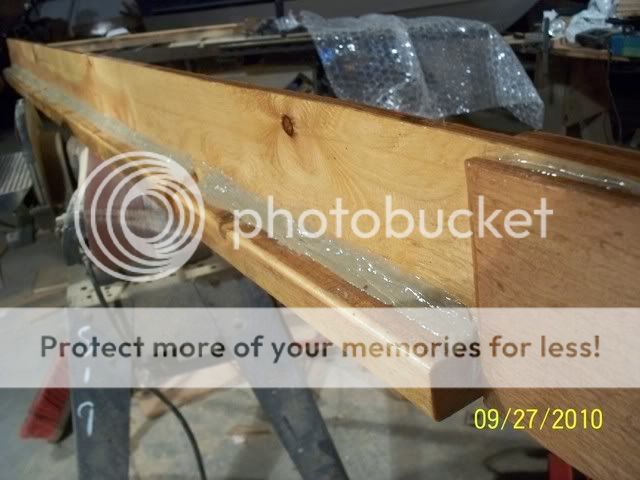

Just came in and thought I'd post a few pics of the progress.
a view of one of the stringers that I have upside down. I use PL to make a fillet so the glass would flow better in the corners.
A view of the other stringer with a fillet.
