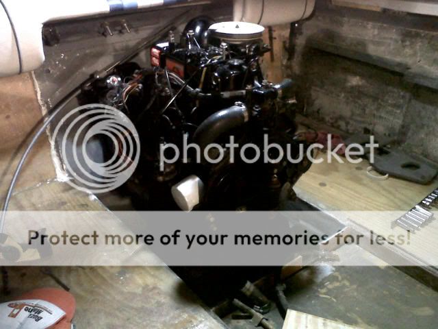

Took a picture of the 140 horses that I put back in the barn last night. Trying to keep progressing as the boat is now not in the heated shop in town, but back at my shop at home.
Installed the engine and will begin cutting to fit some of the bow pieces so I can seal and install them this weekend.
Picture of the engine sitting back in its rightful place.:facepalm:
Sail on.....tink
Only thing I forgot was to put the bilge pump in before I dropped the engine in.

Nice work Tink. Looks like you will make your target date. The motor looks great! ...and what did you do to get the blue finish looking so nice?
