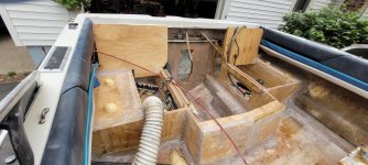

I have a question in regards to smoothing the floor. Am I able to use fairing compound on the floor prior to gelcoat application?
52,429
dont know, I always added a layer or two of glass, then hit that with 40 grit on the DA, followed by some good fairing compound. then I textured the floor with thickened gel

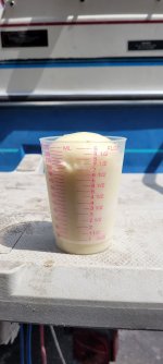

I'm starting some of the installation of the floatation foam so I can finish the stern once the holes are sealed but I wanted to show how much the foam does expand. I put approximately 5 ml of each part in the cup and it's amazing how much it reacts (expands).

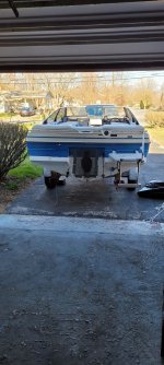

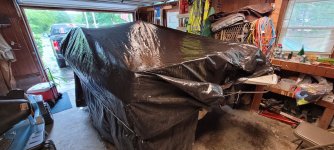

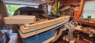

Well May has been so Topsy turvy with high temperatures in the low 40's so nothing done 😞. Next week will be good temperature wise so with having some days off during that time it looks good to get started again even though it'll be in and out of the garage.

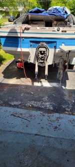

Good morning everyone,
I'm getting ready to "knotch" the transom for the drive steering arm and wondered if there were any tricks. I have a 1-3/4" hole saw and was going to mount it and whittle away accordingly and of course I didn't take measurements of that 😔.
Thanks,
Jim

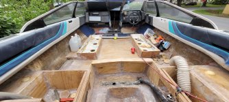

Some progress.....
