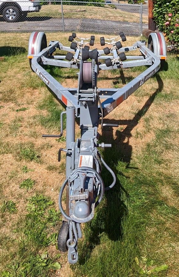

I google the trailer and came up with this. Does it match yours?
