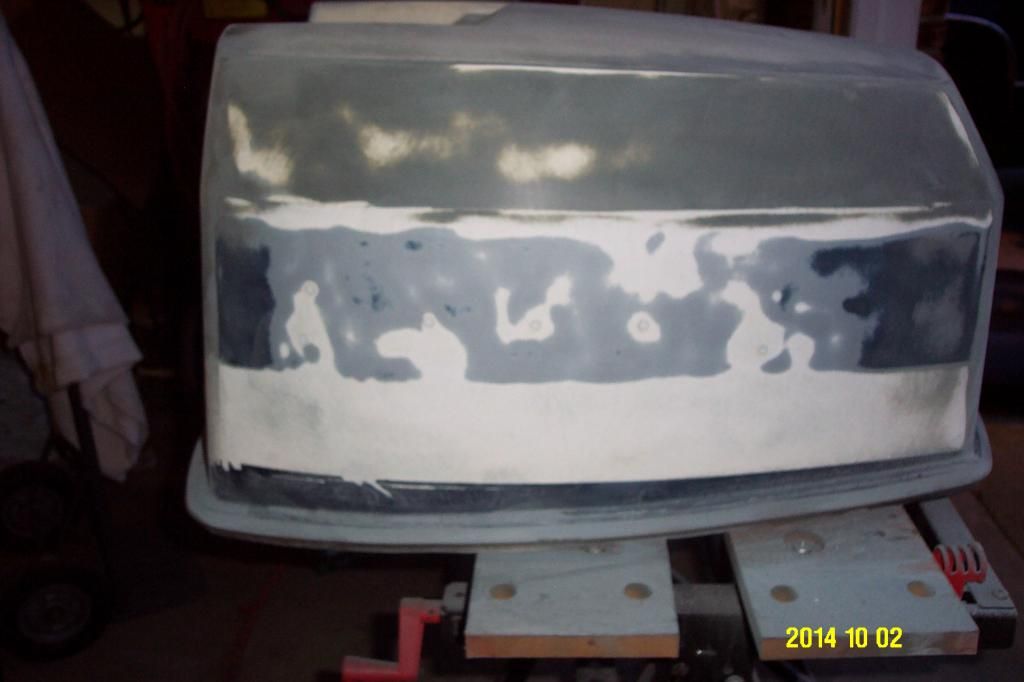

I recently did my cowling and pretty much did what you're doing. I Sanded it down with 60grit then 100, then 180 then 220. then 320. Then shot 2 coats of high build Primer to take care of any small imperfections. Sanded with a 3M ScotchBrite pad and Shot 2 Coats of Tractor Paint with Hardener. Let cure for 4 days and Put on the decals. Turned out Great! You can DO IT!!

Thanks WOG for the confidence! I went though the Blue Flamingo thread and would be very happy to have my outboard looking as good as it! :hail:

Massive looking progress, SBB!
Keep up the GRRRRRR-8 Work!
Thanks GT but I feel more like Minimalist progress! :facepalm: None the less it is forward I think. :thumb:
Thanks for stopping by and as always looking foward to the Bassassin updates!:hail:

Progress is progress, even if it feels small. Motor is gonna look sweet!
