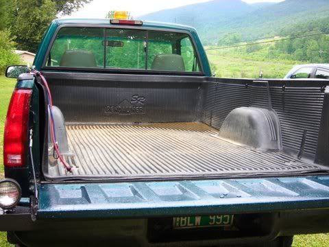

Just about Done. :) I am picking up a new hitch (junkyard) this week and going to replace the old one that is rusted through. Before I re-installed the bedliner I painted the new steel and inside of the bed. I added the stake pocket hold downs to keep the liner even tighter to the bed. I am pretty satisfied on how it came out.
