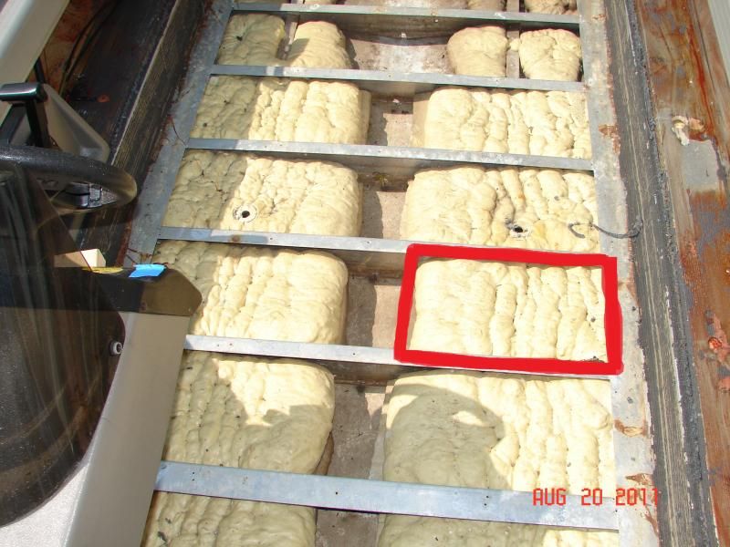

This is a pic of the foam in my '97 Tracker taken in 2011, 14 yr. old foam. Bone dry and light as a feather:
I know the foam was dry and light as a feather because the section outlined in red had somehow dislodged and was laying in there loose, when I picked it up to examine it it was as dry and light as the day it was installed. So I glued it back in place with some 5200 and didn't think anything more about it. I bought this boat brand new and tried to take as good of care of it as I could by keeping it trailered and covered when not in use and the bilge plug removed. I've been caught in several rain storms with it, launched with the bilge plug out, and turned the garden hose on it on the inside to scrub it out regularly and none of this had any effect on the foam.
I guess if you've only owned old rotten boats and never owned a brand new boat and taken good care of it, or bought a used boat that has been well taken care of you won't understand the virtues of urethane foam... but take it from someone with first hand experience, it takes a lot of abuse and neglect to saturate urethane foam and it's not something that happens quickly.
