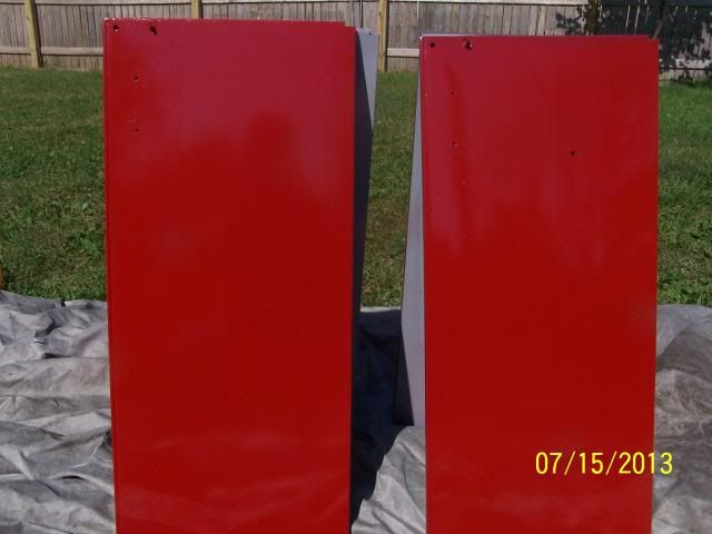

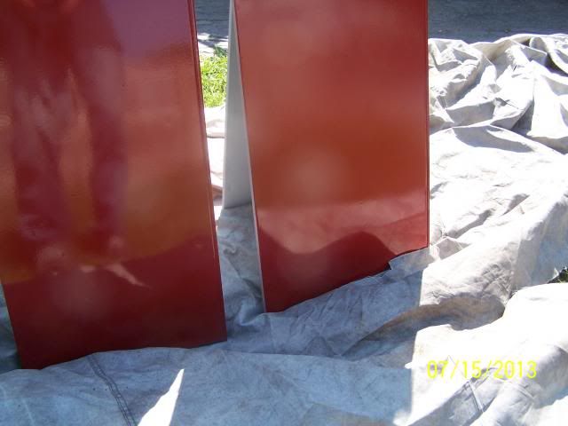

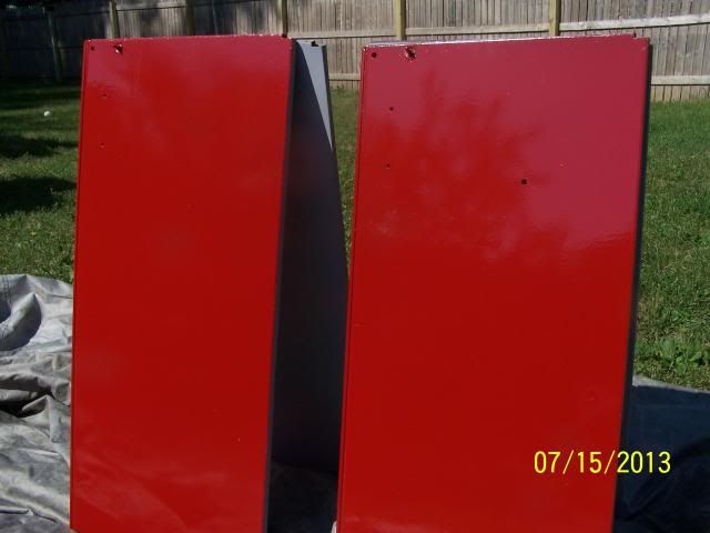

As promised.
Reference of before.
One coat,
This picture is partly the cameras fault. Dirty lens, sun glare.
Sorry I couldn't get clearer pictures with more detail.

Glad to see some pictures here. Looks good too... I've reread most of the comments again to refresh myself to what is going on now. I see you are spraying and practicing...nothing wrong with that for sure. See how quick pride shows up when you accomplish something you've never done before. It is a great feeling too.
As far as "Orange Peel" goes, a lot of professionals still get some orange peel even after years of spraying. Sometimes it's the gun, the paint, the thinning, the humidity, the air pressure and a long list of other issues. Paint drying before it really adheres to the surface/finish is the major contributor of that. BUT, in most cases, Orange Peel can be rubbed out with polishing compounds...if it isn't too bad. But keep trying and you will see that your project will turn out so much better then you once thought... :thumb: :thumb:
