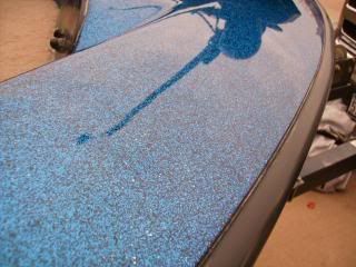

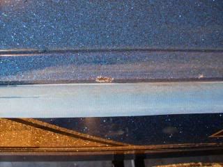

Let me explain a little to see if we can see the page the same way. I am only wanting to fix small minor areas but was thinking one gun with multiple nozzles choices would be a great way to go. I thought i showed these photos before but let me show you a couple areas here i am re-doing now.
and here are some old repairs where the top photo is before and the bottom photo the afters
Now these are what i call minor and should be easily fixed with the proper equipment. I read and read so much on the internet and on these forums that you should have certain nozzles tip sizes for certain resins, epoxys, etc.... and if you want to be able to spray gel-coat--you need at least a 2.5mm or greater or you will be thinning these gel-coats out to be able to spray them.(which is what i am trying to avoid)
Now i have sprayed gel-coat in the past with a preval sprayer but did use acetone and a slight tinge of yellow became of it. Learned my lesson on that tip to never use acetone to thin gel-coat.
I like spraying gel-coat and enjoy fixing most of my own stuff. Although I am in the medical field i am pretty handy with everything else around the house.
now the above repairs may not be perfection by any means --but to the naked eye --its pretty darn good...
To me the G100 Looks like a pretty darn good gun and without the mess you get with other guns... and the ability to change nozzles all the way down to .8mm--all the way to 7.1mm--sounds like a very versatile gun...But what do i know??
But if you could offer more assistance I am all ears for how you would make those top two repairs--Remember that $$ for product should not be an issue when i am fixing it myself. If HF tools are not sufficient tools then please direct me elsewhere.
But to me this is my plan
1. wipe with Acetone and prepare the area with my dremel and start the faring process and then i am going to fill these areas with the proper fiberglass(cut up into tiny piecese), spreader, resins and hardener--lets don't talk about all the different sizes and uses of sanding equipment as i think i have that down to a science.
2. Allow said process to cure and then YES--sand...for the sake of words we will just say i have the process down.
3. spray the base coat with US composite Neutral gel-coat that has been mixed with black and will NOT BE using a surfacing agent and allow the coat to dry to a tacky cure--as i will be blowing(before it cures fully) on flake(blue and gold--that i got from TCP) with a straw--no sanding at all here.
4. Now here comes US composites Clear Coat which i will spray(with what gun--i don't know yet) and again not use a surfacing agent but just MEKP as a hardener.
5. I can keep adding coats of clear one at a time(without surfacing agent) about 10-30min apart till i get about 2-3 extra coats of clear in place.
6. Final coat--i am going to be using One final coat of clear mixed with MEKP, surfacing agent, and was thinking patch-aid at this particular time.
After full 24-48 hour cures---SAND, SAND, SAND--and when your tired of Sanding --go to Wet sanding ---till you can't sand anymore--THIS IS A JOKE here--hehehehehhehe
ok YD, if I am missing something or you would like to please add your thoughts i am all ears... If you see something in the process that doesn't look right --please be my guest on changing something

FINAL product after said Sanding, compounding, and waxes--of those previous repairs that i showed above of some repairs already made
Yacht Dr.
Feb 26, 2005
5,581
Re: Calling out ONDARVR and Duratec
Its the end result that matters :) and yours looks great..
Your list looks good to me.
Im thinking of a small pressure pot system for nonthinned gel..
Although the g100 im sure would do it, I just dont know how precise you can get with it. Honestly I have never tried to do a small patch repair with a dumper so I cant tell you how well it will work.
If you do use the g100 please let us know how it worked out for ya :) .
