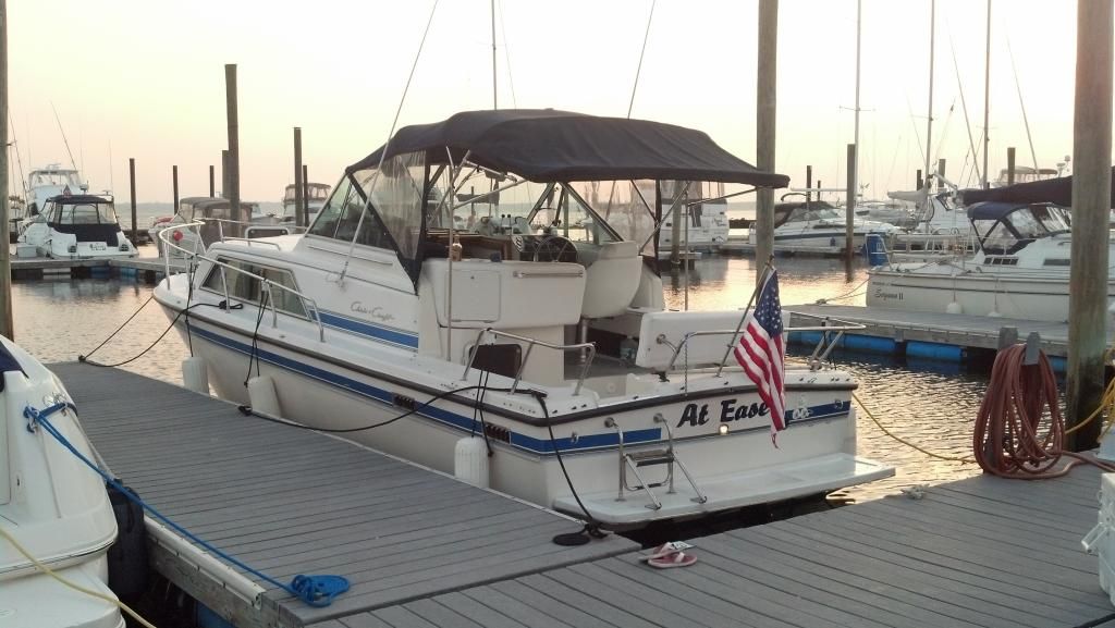

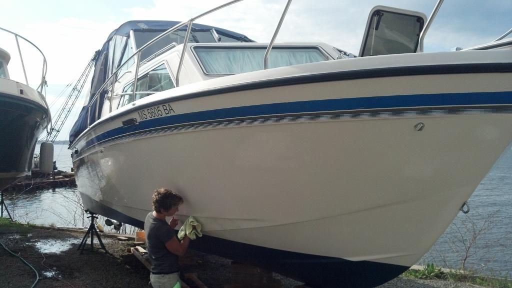

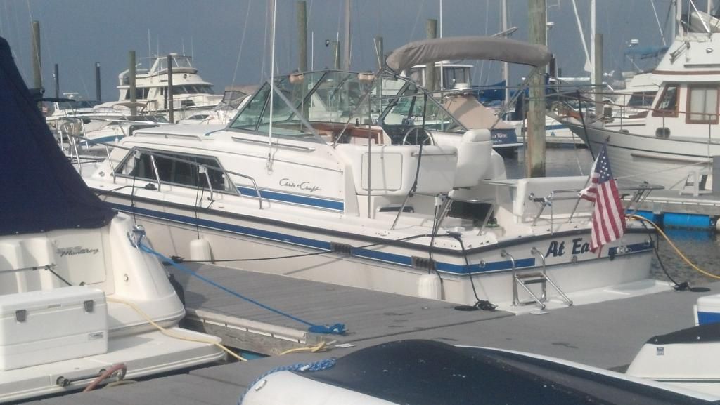

Thanks again guys. I'm going to download photobucket and try to post a few pics of my boat just so I can get the hang of it. The boat is at the marina , I keep it stored there in the winter. There is no issues with me working on it doing whatever I need to do. I have power there, The 100 plus inches of snow we got in Narragansett Bay this year is beginning to melt fast! I'm heading down there for a week starting Thursday to try to get a good idea on how big this job is. I have owned boats since 1980. This is my 6th boat. I have owned it for 3 years, I got in in Kingston ON Canada. It had original gel coat on the hull. No bottom paint and not one day in saltwater. I am very mechanical and can fix any motor, but need lots of guidance with this one. It is very comforting knowing there is a group of people like yourselves out there that actually care about what I'm about to take on. I hope I can return the favor one day to someone else out there, Last week I thought this one might be out of my league but now, not so much!

Wow this one looks kinda difficult . It's gunna be pretty hard to get to every where there is delamination without taking the world apart .. The stringers that run next to the chine are so close to the edge that it would be hard not to re-tab the plywood back along the edges ....
Btw , she sure is pretty !
