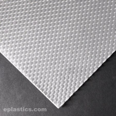

52,380
another option for non-skid are the fluorescent light diffusers.$10 a sheet 24 x 48 sheet at lowes
https://www.eplastics.com/Plastic/l...2BYa_hgOkSOyNSAEj6zzuXhRjIYSnywBoCw48QAvD_BwE
https://www.homedepot.com/p/Metalux...CUbAQAvD_BwE&dclid=CM_joYHs6dwCFQkcaQodfdgB6A

Thanks for the idea, Scott. I’ll have to see what the Gibco pricing looks like.

Looks like the Flex mold (Gibco) stuff is about $55 per 1 square foot at retail pricing. I did put in an inquiry into Gibco to see what a couple of large sheets would cost, but I don't have high expectations that the price will be reasonable. If I used a single square foot of this material, essentially I would have to make the entire pattern, 1 sq. ft. at a time using a negative mold in a step and repeat fashion. . . . probably not worth it.
The guy on the BoaterEd site indicated that he used the lens material for ceiling lights, as Scott had suggested. I am also searching for some textured rubber material that would also be suitable.

Just got word from Gibco about using 'full sheets' which I would need 2 of them cover the non-skid areas.
$370/sheet or $740.00 total for this project. Not worth doing it for a single custom unit. I can see that the production mold makers don't mind the cost, as it is minimal vs. the production run.
Anyway, I'll go the plastic panel or rubber mat route and try to come close to the pattern.
