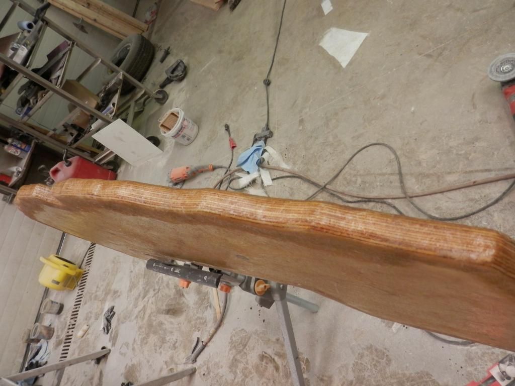

Ok sanded it down to raw wood put a coat of resin on both sides and edges . Back to it tomorrow

I think my phone will video . But basically I do it like frisco a small paint roller pour on some resin and roll it around till transparent it looks good till it hardens then seems to be a bunch of little air bubbles will try video in the morning

Are you SURE they are air bubbles and NOT variances in the color of the glass. Have you tried rolling on a light coat of resin over the top after it's cured and tacky?

No I am not sure they were small patches that were white. No I did not go over it didn't want to make it to resin covered.
I turned the heat up to 73 and will get to it today
Is 1% good ratio and how long should i mix my resin

I'd kick it up to 1.5%. Since you'll be laying 1708 over the top I wouldn't worry about applying a thin, don't need a lot, "cover coat" of resin to possibly fill any of those pesky "Bubbles" It might just be some "Resin Starved" areas needing to be filled with resin doncha know!!!;)

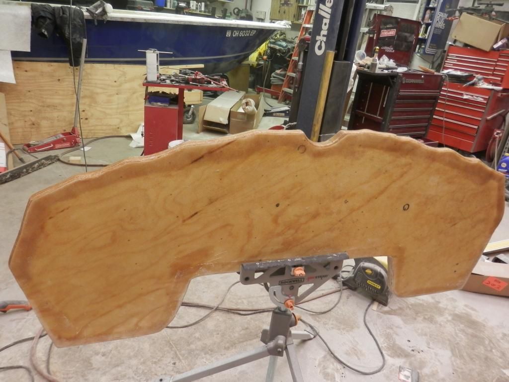

Well I think I got it there are a couple little air bubbles on the over lap but I can sand them down and patch them in they will be covered in pb anyway will post pics tomorrow

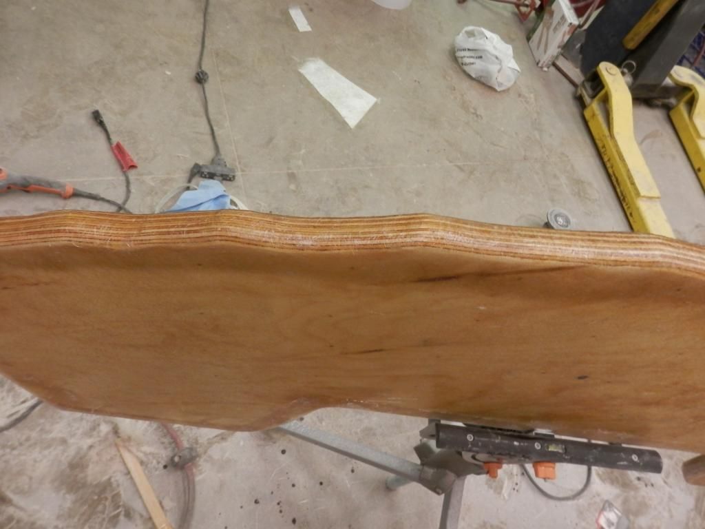

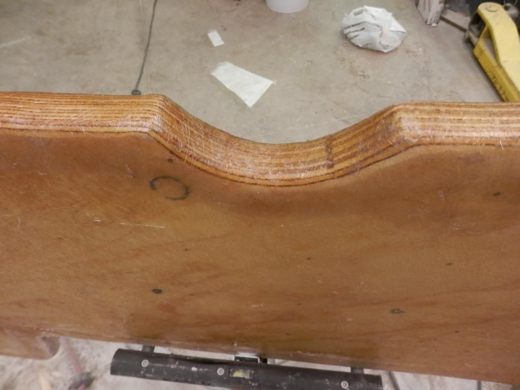

Uhmmm, Let me say this...When you consider the fact that the boys at the factory come in hung over on Monday and are in a Hurry to go Home on Friday, then Tues, Wed and Thurs are the "Good Days" That would be a Wed Transom!!! Me Thinks Thou dost protest to Much!!! Remember the CSM is a Binder to keep the resin from cracking open so it provides water proofing for the wood. You will be applying additional layers or resin and cloth as well as PB Over the top of this sooo, it will take care of any inconsistencies that may now exist. As long as there's no Major bubles or areas where the mat has lifted, and I don't see any of that, It will be fine, and I'm totally sure it was fine before but...you're learning as we all have to do. The Old Man at the Marina that first taught me to lay glass back in the 60's always said "Kid, just make it so you're proud to put your name on it, and...it don't come back thru the door!!!!":eek::D
I'd put my name on the transom in that pic!!!!:joyous:

Nice work, especially with all those contours along the bottom edge. Very nice!
