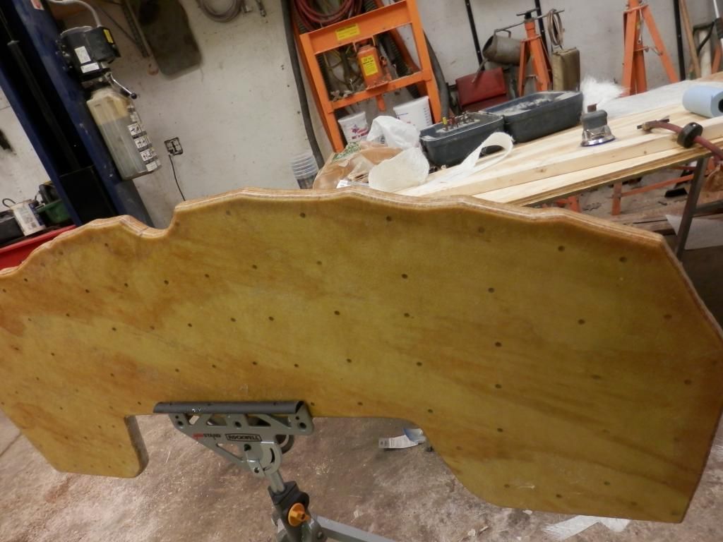

Ok almost time I want to make sure I am doing this right. Pre soak wood with resin mixed at 2% layups at 1.5% garage temps 65 degrees

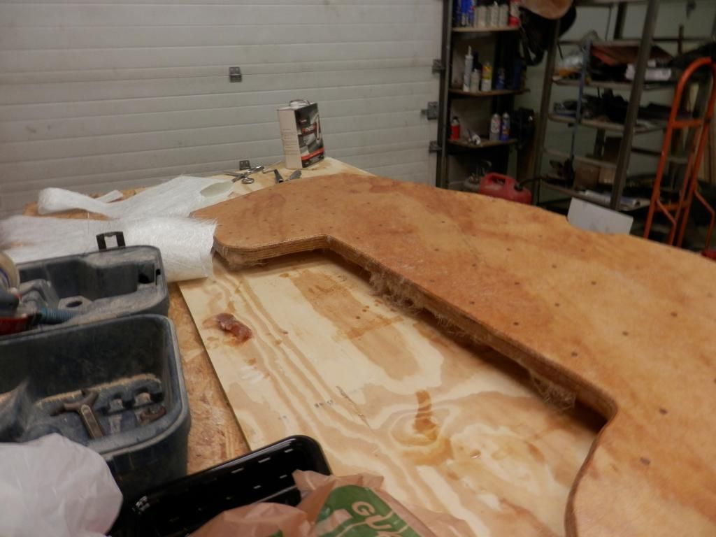

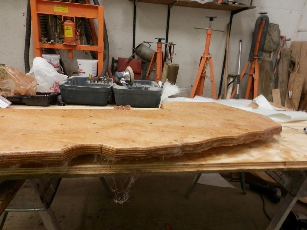

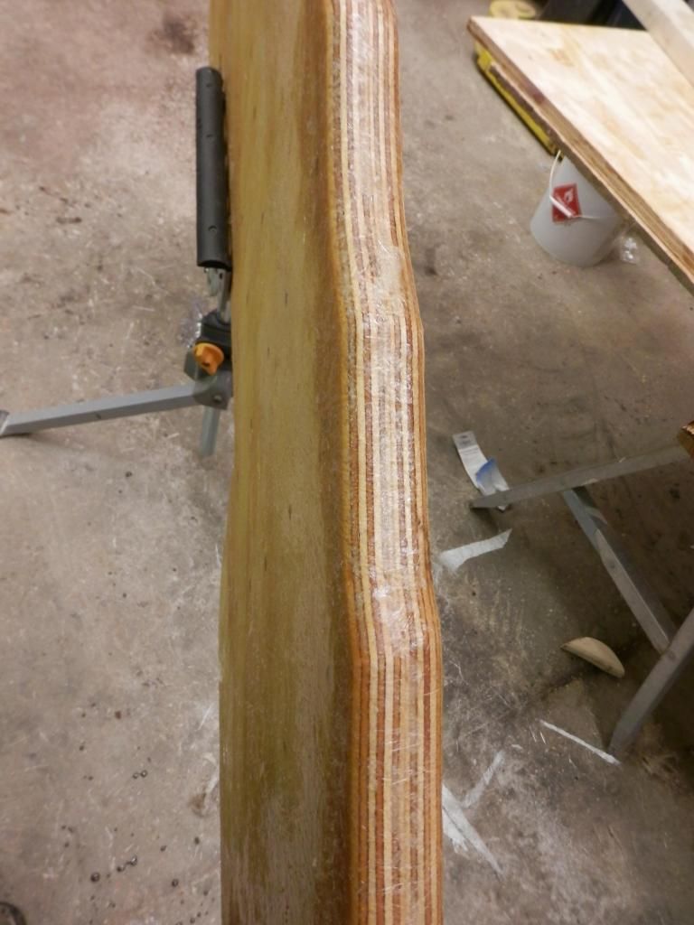

Well my first go at it did not go well The flat section seems good but going over the edge not so good. It kept like hairing up for lack of better way of saying it Hopefully I can sand off the bad and try again tomorrow
Woodonglass
Dec 29, 2009
25,930
Re: Deck coating / Turned complete restore
Use less resin on the edges!;) DAB at em with a the brush gently and don't over work em. Once the fibers lay down move on. You can come back later when it starts to tack up and work it a bit more with a bubble roller if you have one or some plastic and your hands.

Ok wood I will do that And I am ok just sanding down and redo the edges Or should i redo the whole side
ahmincha
Jul 21, 2012
1,512
Yes I have a roller round 2 tomorrow
Woodonglass
Dec 29, 2009
25,930
Cut some 3" strips and just redo the edges. Sand em smooth and Lay down the strips. You'll get the hang of it. Don't sweat it. It takes a while to get the hang of it. The flats look GOOD!!!

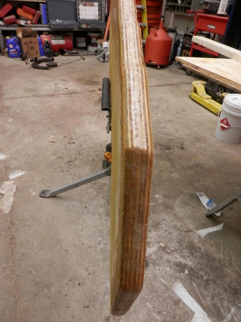

Redid the edge came out better still a couple air bubbles learned to not go in different directions when spreading resin over glass
Woodonglass
Dec 29, 2009
25,930
Personally I'd use PVC. Your Glassing is getting better. You're learning by doing!!!!:D Best Way!!! Wrapping edges is one of the hardest parts to get good at. Bottom edges not as critical if you're bedding in PB. Get as much resin down on the substrate as you can and then dab on the CSM to drive the resin up into the mat from the bottom up to wet it out first. Then add a bit, not much, more resin on top as needed. Most people use WAY to much resin. To more you use, to more you'll learn how much is needed Remember, One gallon of resin should be able to wet out and entire 4x8 sheet of plywood covered with 1.5oz CSM.

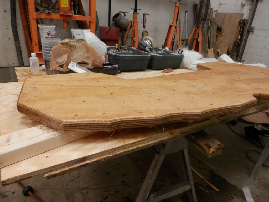

Ok I think I am doing something wrong . It seems like it taking to long for the resin to set up ahnd I cannot get rid of small air bubbles. Garage and material temp is 63 plus degrees no breeze doors shut I am mixing 2% 200ml resin 4 ml mepk now I did not stir up resin in 5 gal pail is that a prob? How long should I stir in mepk?
ahmincha
Jul 21, 2012
1,512
Ok last attempt I raised heat to 73 mixed 2% roll out the resin and it seems to pull the glass strands and bunch them up this is happening on the flats and the edges any help will be appreciated
