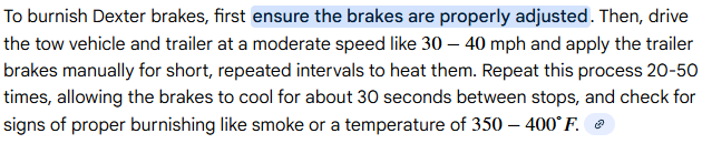

bruceb58
Mar 5, 2006
30,797
Very likely the shoes were never burnished properly.
Do this procedure before you do anything else:
