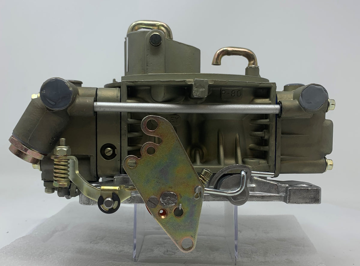

Has anyone ordered a carb from https://www.carbcareusa.com/ ? are they legit at $510 for a marine Holley 4160 with electric choke?

And where in the add does it state what it is other than a 4160 which is available in 390 to 750 CFM

brand new
750 CFM
$597.95
not much more for new with new warrantee.

brand new
750 CFM
$597.95
And it is a 4150, easier to Calibrate the Secondary Metering, than a 4160, however the pic shows Idle Mixture Screws on the Secondary Metering Block. Could be a generic pic though, as the Throttle Lever shown is an Auto Style versus the Flat one Holley has on their Marine Carbs.

Butchering Already done, No Extra Charge...
What butchering?
Other than coming with a fuel feed and most likely needing to be gone thru from sitting. I don't see any "butchering"
