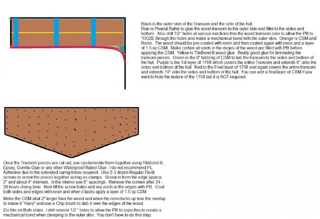

Ok, decisions made. I'm going ahead with the TRS drives. So, first things first, The Transom! I have tried to read as much as I can but hope that I have not interpreted anything wrong. Am I right with the following procedures?
1, With a circular saw, cut lines in the old transom wood, no deeper than the outer glass.
2, Cut out the floor and stringers, at an angle to the transom. Check stringers for rot and remove any if rotten.
3, Chop out all the old transom wood and grind back to clean glass, 6 inches all around repair.
4, Make a template for the new wood and cut out two pieces.
5, Drill 1/4 inch holes through one piece at 6 inch spaces, to allow PB to exit and to give a physical bond.
6, Bond both pieces together with PB.
7, Grind down existing drive holes, to leave a feathered edge. Clamp melamine board, with release wax, over the existing holes. Gell coat and build up the holes to match the overall thickness of the outer skin.
8, PB the transom wood to the outer skin and tab it to all sides.
9, Replace stringers with staggered cuts and tab into transom.
10, Glass over entire repair.
11, Replace floor and glass in.
Hope I got it all right.

Nope,... Not that I can see,...
I'd assemble the transom pieces, In-place, rather than on the bench,...
The pieces are easier to get into place than the Whole thing...
'n by usin' any holes in the transom, you can clamp the pieces together usin' bolts through the holes in the transom..

Do you know what type of layup I should be looking at? I have found the image below, on here. It's a little hard to read but I am guessing I can follow this but glue the wood together with peanut butter and CMS?
Thanks again, for all your help.
Peter

Thank you Woodonglass, much clearer.
