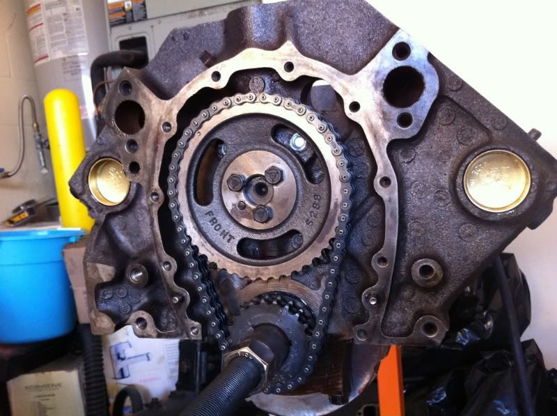

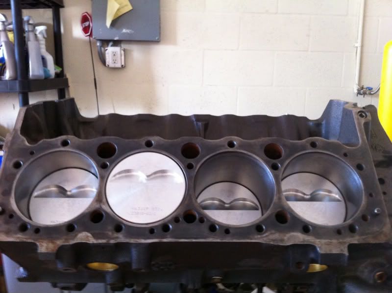

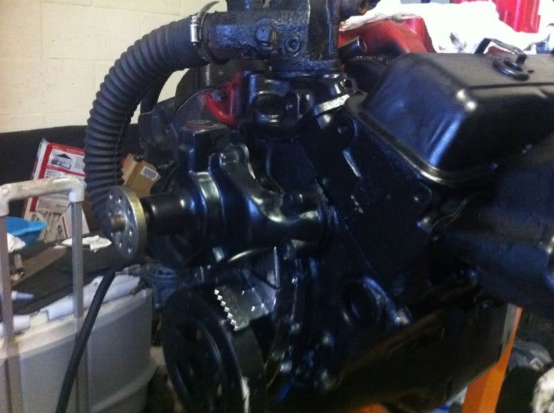

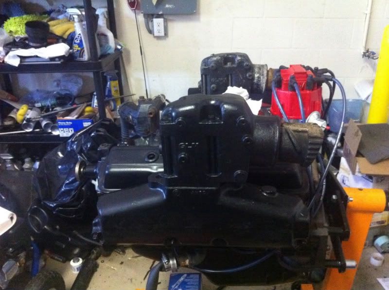

Well, Ive been really busy redoing the interior of my boat. Im still ot done with that but I wanted to get some work done on this engine.
Heres some before I started on it yesterday pics.
As of right now I have almost the whole engine together. I have installed: heads, intake mani, timing chain, timing chain cover, harmonic balancer, exhaust manifolds/risers, oil pump, and the oil pan.
Ive attached some pics from before I started yesterday, and a couple from when I was done.
I do have a couple questions.
Is there a certain spec for how far the balancer goes onto the crank? I have it on as far as I could get it. I rented one of the balancer/gear/pulley installers but I still didnt want to chance ripping the threads out of the crank.
And on the dizzy. It doesnt matter what way the dizzy is facing or whatever as long as when I stab the dizzy with the engine at TDC whatever plug wire the dizzy is pointing to I made my #1 plug wire. Then I just ran CLOCKWISE (no?) through the firing order. Is this correct?
Ayuh,... The balancer goes on, til it bottoms out....
And,...
Yes, you have the distributer installation correct...

Re: First engine rebuild
Thanks Bond-O.
I'm pretty sure it is bottomed out. I was scared to rip the threads out of the crank. I may use a piece of wood and a dead blow hammer to make sure it is seated all the way. I hate to beat on this crank though.
6meter
May 15, 2010
525
Lookin good Lac! I have always pounded the balancer on then put the center bolt in and tightened it up with an impact gun. Never did I strip the threads. Make sure your timing marks were lined up on the crank and cam gear. Stuff a rag in #1 spark plug hole, turn motor over and rag will pop out, turn a little bit more to line up at TDC on timing mark, drop dizzy in where you want #1to be, yes it can be anywhere, just this way the timing might be close and look good. You might have to turn the oil pump rod to line up the dizzy. HTH

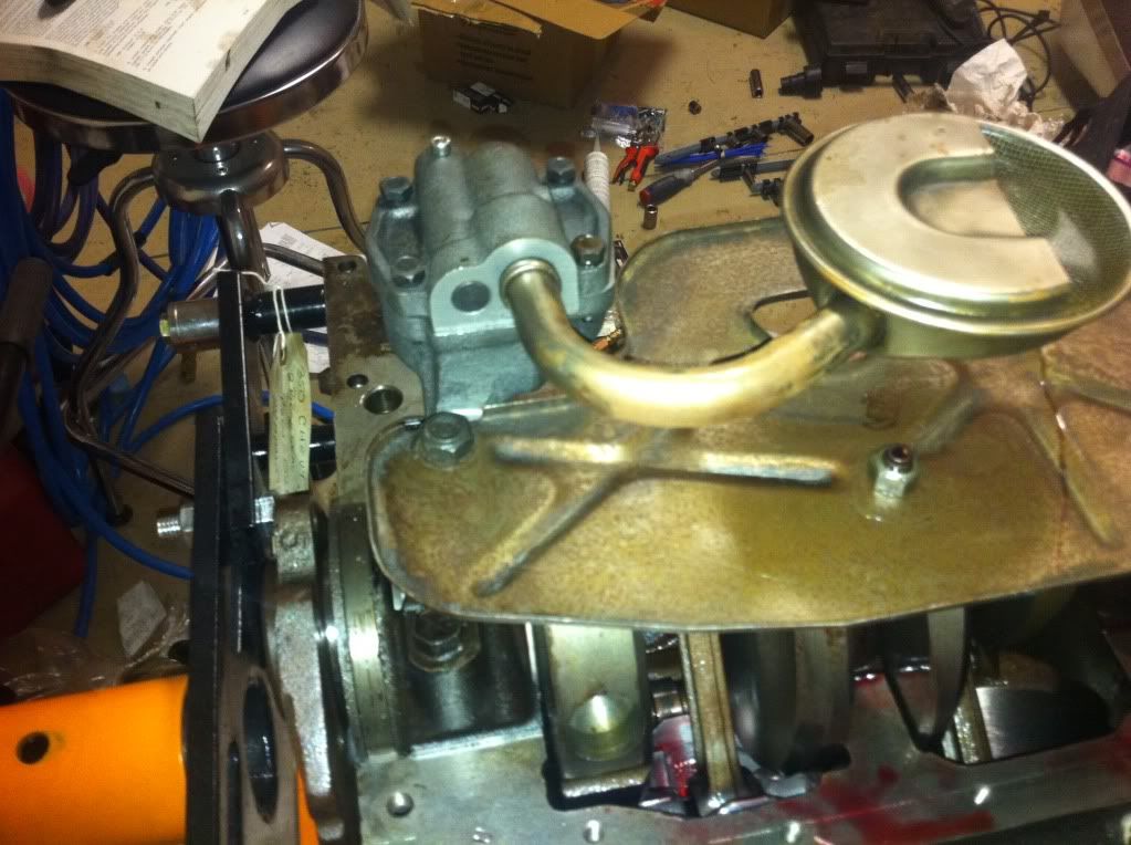

did you tack weld the pick up for the oil pump?your pics dont show it... i am rebuilding a engine right now a 350 infact that the pick up wasnt tack welded and the pick up fell out and ate the crank alive.
Josh P
Aug 26, 2009
328
ok good didnt want to see you waste money... Didnt know if you knew to do that or if someone told you to so i figured id ask since it didnt look like it in your pic.. glad to see you got it running
