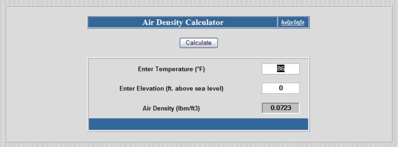

The air density calculator here will tell us how much a cubic foot of air weighs at the 86F temp:
http://www.denysschen.com/catalogue/density.asp
Since it weighs .0723 lb/cu_ft, and our tank is 26.78 cu_ft, that means we have .0723 x 26.78 = 1.933 lbs of air in the tank.

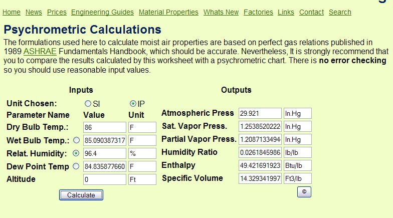

The Humidity Ratio is the amount of water in each pound of air. To find that, we divide the weight of water in the tank by the weight of the air: .0506 / 1.933 = .02618.
Now we can find the Relative Humidity he assumed, which will give us the Dew Point also. Easiest way is to adjust the Relative Humidity number in the psychometric calculator below till the Humidity Ratio equals the .02618 we calculated above. The only numbers I entered were the dry bulb temp of 86F, and then I played with the Relative Humidity entry until the Humidity Ratio equaled .02618 as we calculated above. Everything else was calculated by the psychrometric calculator webpage.
http://www.sugartech.co.za/psychro/index.php
What this means is that the ONLY way possible to have .81 oz of water in a 200 gallon tank at 86F is to have a Relative Humidity of 96.4%. Nothing wrong with that, he's free to pick any starting point he likes.

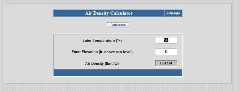

Air density at 50F is .0774 lb/cu_ft
So the tank has .0774 x 26.78 = 2.073 pounds of air in it.

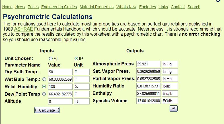

.0287 / 2.073 = .0138 humidity ratio.
Now go to the psychrometric calculator, put in a dry bulb temp of 50F, and adjust the Relative Humidity until you get a Humidity Ratio of .0138.
As you can see, it would require a relative humidity of 180% to meet his condition that at 50F a 200 gallon tank contains .46 oz of water. Ain?t no way in this universe. Hopefully everyone here is aware that 100% relative humidity means that the air is completely saturated and can hold no more water. It?s possible to get briefly above 100% in a supersaturated state, but I very seriously doubt if many boaters have a Wilson Cloud Chamber and do nuclear physics experiments in their fuel tank ?.
