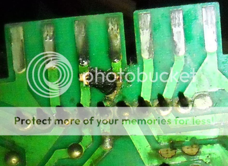

Finally found the problem. After tracing and checking through all the electronics and relays (the diodes that power the inducer relay, tearing apart the relay, checking the motor, etc.) I found it.
There was no 120v supply to the motor even with the relay shorted. Tracked the wires backwards to a connector on a circuit board in the blower cabinet. I pulled the board out, flipped it over, and found this:
This summer after a thunder storm I had a blown circuit breaker to the furnace. Assume we had a lighting strike nearby. Reset the breaker and air conditioning was fine, so I assumed no problem.
OOPS !! If you look closely to the lower right of the black burn you will see a section of the trace is missing. I also see a couple of bites missing out of the trace at the bottom.
Now I either need to fix the traces with solder or see if I can find a replacement board and hope nothing else is bad.
BTW - the board has a model number HH84AA009 in case anyone has a lead on these

Actually the motor looks good. No burns on the wire, no marks anywhere else, motor has continuity and spins freely.
The only indication I have of any problem is the picture shown (and of course that it does not work)

It sure does look like it. Thanks.
Really appreciate everyone helping to save me money.
dolluper
Jul 19, 2004
3,906
Re: Furnace Problems
Thats an upgrade board Gary found for you ....cheap and neat the way they use an auto fuse
