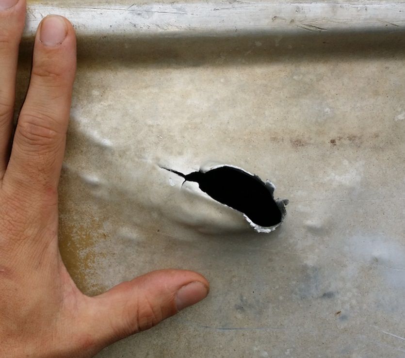

I guess it's all in what you know.
When you see this...
you may see an easy repair, but not me. I have seen the suggested methods for this repair and have seen the repairs when they're done. The Tinners say they are War Scars and to wear them proudly. Well that's not what I call em but to each their own. That may be considered an EASY repair to a Tinner and I suppose in a way it probably is. A couple of hours with some tin, rivets and sealant and you can have it patched. But it'll look like, to use your descriptive language that you so often use with Glass boats, a P.O.S. ! On a glass boat with that same hole and in about the same amount of time and effort I can patch that hole and make it virtually disappear. There won't be a Scar. It'll look New again as it should. Again, to each their own. I'll admit I HATE the itch and the dust of glass restoration, but the smell don't bother me and I LOVE the look and designs that can be acheived with Glass. Buckin Rivets don't look to be much fun either and pourin Gluvit into seams has it's challenges as well. Let's face it. Tin or Glass they both have their own challenges. Bottom line for me is...If it has "The LOOK" that suits me, I don't care what it's made out of, I'm Interested! I saw a boat made out of recyled 2 liter coke bottles that caught my eye for a bit, but the Admiral but the quietus on that in a hurry!!!:lol::D

WOG, that pick axe hole shown there (from rob3307's post) is an easy fix. hammer and dolly, then tig weld to seal back closed. a bit more hammering and a bit of buffing with the DA and 280 grit and you would never know it was there.
you could patch it with rivets, a patch and sealant, however, why when there are better repair methods. Then again, we deal with aluminum construction and repair every day at work.

Hey SD. thanks. Yeah, but I've not seen or heard of to many DIY'rs that have the ability to re-weld their boats in that capacity. Most of them apply the rivets patch, or at least that's my limited experience. I FREELY admit I DON'T spend a lot of time cruising the Tin Boat threads so I may be WAY OFF BASE. I know for sure IDON't have that skill set to make a patch like that disappear, I'd have to have someone like you do it and pay for it. Being a C.O.B. That goes against the GRAIN. If you know what I mean!!!:facepalm: But I have seen a LOT of Newbs that can't spell fiberglass come one here and so some pretty impressive glass work by the time they're all done. Don't think they pick up Aluminum Welding quite as fast. But I could be wrong about that Too! Heck everybody knows I am just an... and sometimes I do put
