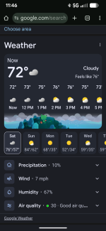

Going to hit near 78 today at Blue Springs state park.
It's times like this that I feel like I've reached the end of the rope for me as far as living in NY. If my son and daughter in law come to that conclusion, we're out of here! Life is too short especially now for putting up with 4 months of cold weather.
