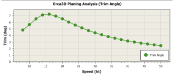

Here is a set of trim angle diagrams I put together, based on the analysis . . .
I was interested in having the hydro-static and speed/power analyses done to see if there were any detrimental concerns of the design. Overall, things look OK.

Okay. I have a question. On the hump angle... my experience has always been that for the most part it's pretty close to dead rise until you climb on top. Ie my 19, 33 my buddies 38 etc... all basically rise to the point of obscuring view until youre out of the hole. I really doubt it's an exact correlation to dead rise angle other than more dead rise you have would seemingly equal more bow rise until on plane... that much makes sense to me. Same as more weight in the back would make it worse too...
Anyway, what I'm asking is, is that 7.2 degrees after you've hit planing speed or in that transition point? My 19 comes up at 16-17mph and is on top at 18ish. At 18 the bow is high but has dropped back down significantly from that of the 16-17 range. Then obviously as speed increases I add trim as the hull is pretty neutral... slight trim is worth 3 mph at wide open and about 400 rpm as the whole wetted surface lifts up and out vs riding on the whole bottom of the vee.

. . . what I'm asking is, is that 7.2 degrees after you've hit planing speed or in that transition point? My 19 comes up at 16-17mph and is on top at 18ish. At 18 the bow is high but has dropped back down significantly from that of the 16-17 range. Then obviously as speed increases I add trim as the hull is pretty neutral... slight trim is worth 3 mph at wide open and about 400 rpm as the whole wetted surface lifts up and out vs riding on the whole bottom of the vee.
The hump speed/angle is the highest angle of incline the boat reaches while coming up on plane. In terms of degrees of incline, it is nowhere near the deadrise angle . . . less than half. Because if it were close to the deadrise angle (18-23˚) folks would be loosing their beer coolers out the back in significant numbers.
This picture probably explains it best. . .
It is the maximum angle the boat rises to before it starts to flatten out. It does generally coincide with when the boat begins to plane (+/-).
My boat 'was' the worst in terms of bow rise . . . and although not actually measured . . . was probably in the 8-10˚ range with the I/O engines.

Thank you sir for explaining it like 2 year old i am. (Charts make everything easy)
Probably just seems worse than it is on the 33 due to how long it takes to plane and the loss of forward visibility. Those wellcrafts are notorious for running very bow high.
