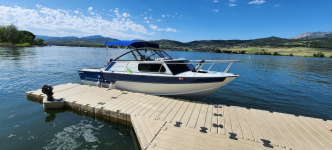

I finally remembered to snap a picture with the boat in the water, usually I'm so busy I forget.
