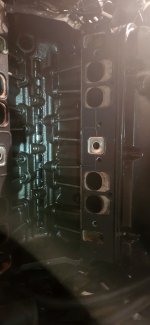

This is the wrong intake gasket isn't it?
Edit - intake ports don't line up. Looks like I might not have the original intake.
edit 2 - I'm an idiot. Wrong gasket. Intake is back off and gotta figure out what gasket i need. 20230817_233813.jpg

All back together and cleaned up. Waiting for sealant to dry on intake manifold.
I really should have just used the sealant on the front and back walls. I used both sealant and the rubb20230819_000523.jpger gaskets and it looks like part of rubber squeezed half way out. We'll see if it leaks when I try to start this thing tomorrow.
No left over parts, missing parts, or unknown wires, so that's at least a plus!

Rectangular Port Gaskets on an Oval Port Head. Happens a lot, as a lot of people don't know that there were the Two Types. For use below 5000 the Smaller Ports are Better. This reinforces my Idea that Mercury planned on those engines likely being entered in Racing Events that required Stock Carburation. The Heads could be changed to the Rectangular Port Heads, along with the Intake, but the Carb had to be the Stock Carb.
